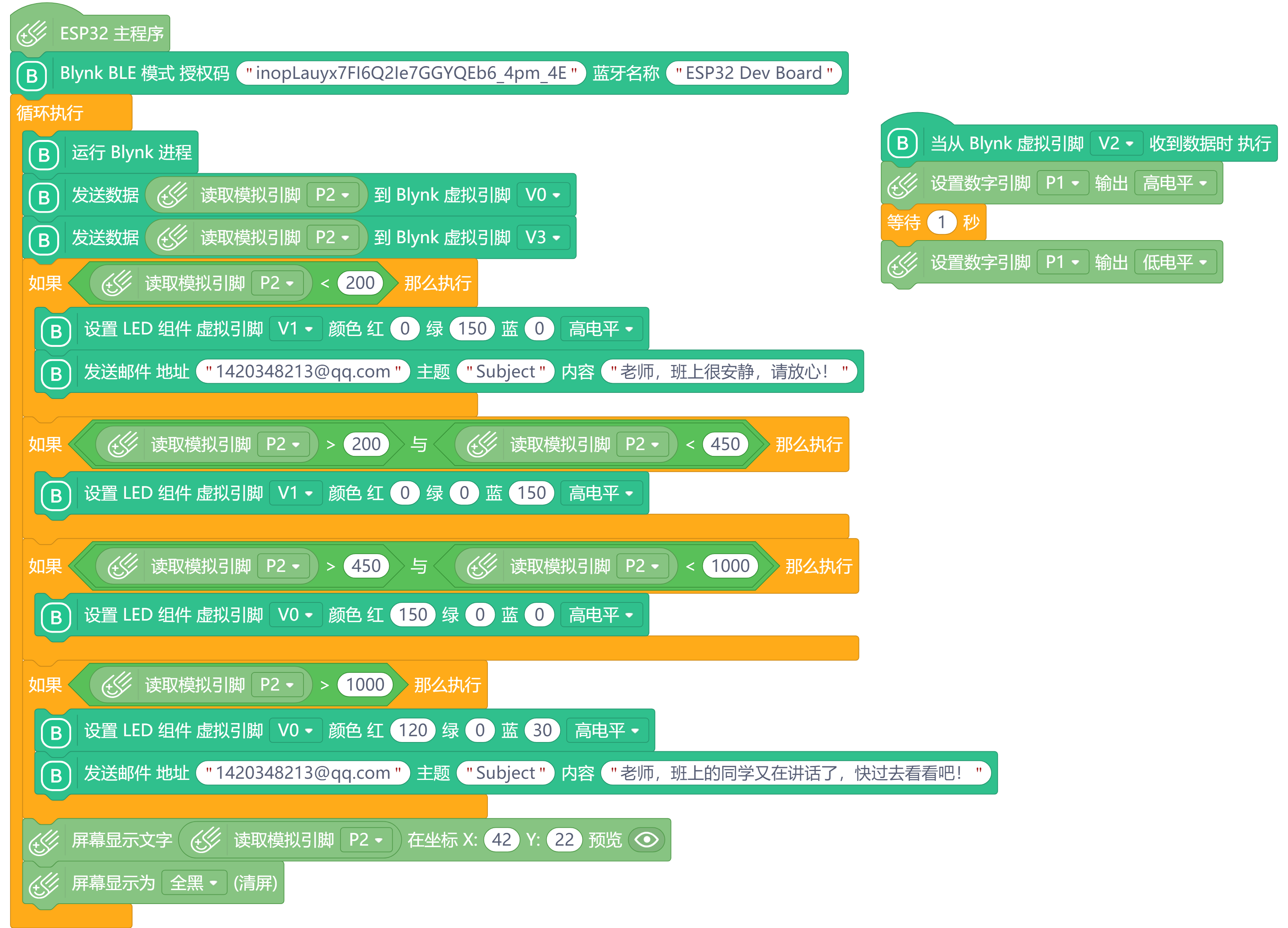

编写程序
代码代码
/*! * MindPlus * mpython * */#include <MPython.h>#define BLYNK_PRINT Serial#define BLYNK_MAX_SENDBYTES 128#define BLYNK_USE_DIRECT_CONNECT#include <BlynkSimpleEsp32_BLE.h>#include <WidgetRTC.h>#include <BLEDevice.h>#include <BLEUtils.h>#include <BLEScan.h>#include <BLEAdvertisedDevice.h>// 创建对象WidgetLED ledV1(V1);WidgetLED ledV0(V0);// 主程序开始void setup() {        mPython.begin();        Serial.begin(9600);        Serial.println("Waiting for connections...");        Blynk.setDeviceName("ESP32 Dev Board");        Blynk.begin("inopLauyx7FI6Q2Ie7GGYQEb6_4pm_4E");}void loop() {        Blynk.run();        Blynk.virtualWrite(V0, (analogRead(P2)));        Blynk.virtualWrite(V3, (analogRead(P2)));        if (((analogRead(P2))<200)) {                ledV1.setColor("#0015000");                ledV1.on();                Blynk.email("1420348213@qq.com", "Subject", "老师,班上很安静,请放心!");        }        if ((((analogRead(P2))>200) && ((analogRead(P2))<450))) {                ledV1.setColor("#0000150");                ledV1.on();        }        if ((((analogRead(P2))>450) && ((analogRead(P2))<1000))) {                ledV0.setColor("#1500000");                ledV0.on();        }        if (((analogRead(P2))>1000)) {                ledV0.setColor("#1200030");                ledV0.on();                Blynk.email("1420348213@qq.com", "Subject", "老师,班上的同学又在讲话了,快过去看看吧!");        }        display.setCursor(42, 22);        display.print((analogRead(P2)));        display.fillScreen(0);}// 事件回调函数 BLYNK_WRITE(V2) {        digitalWrite(P1, HIGH);        delay(1000);        digitalWrite(P1, LOW);}[size=0.8em]C

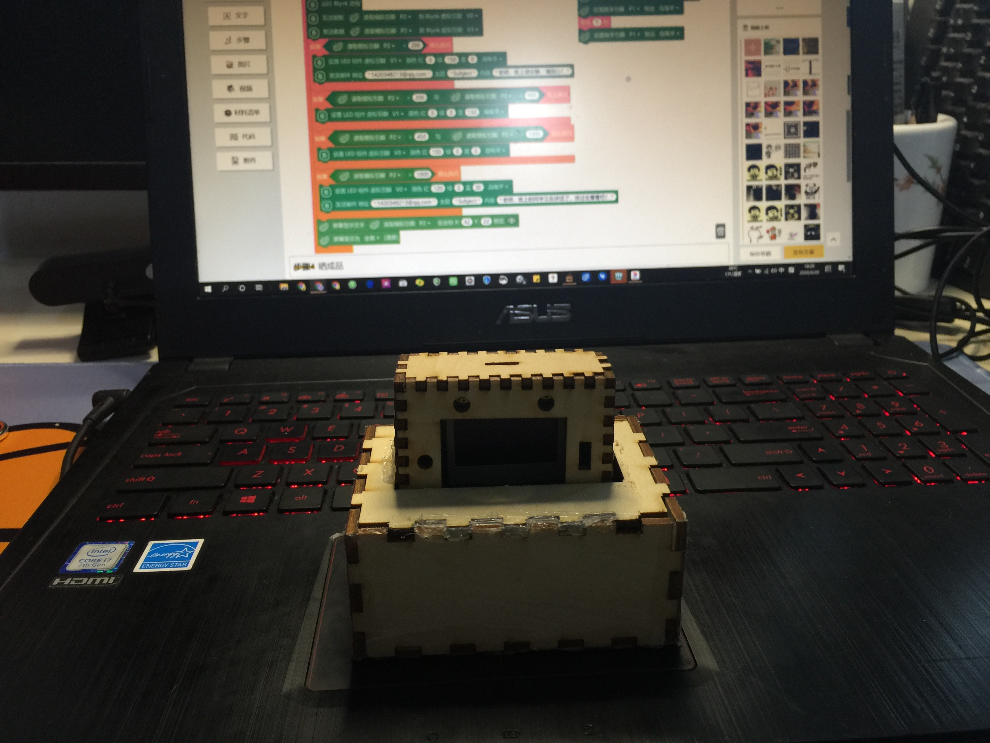

晒成品
