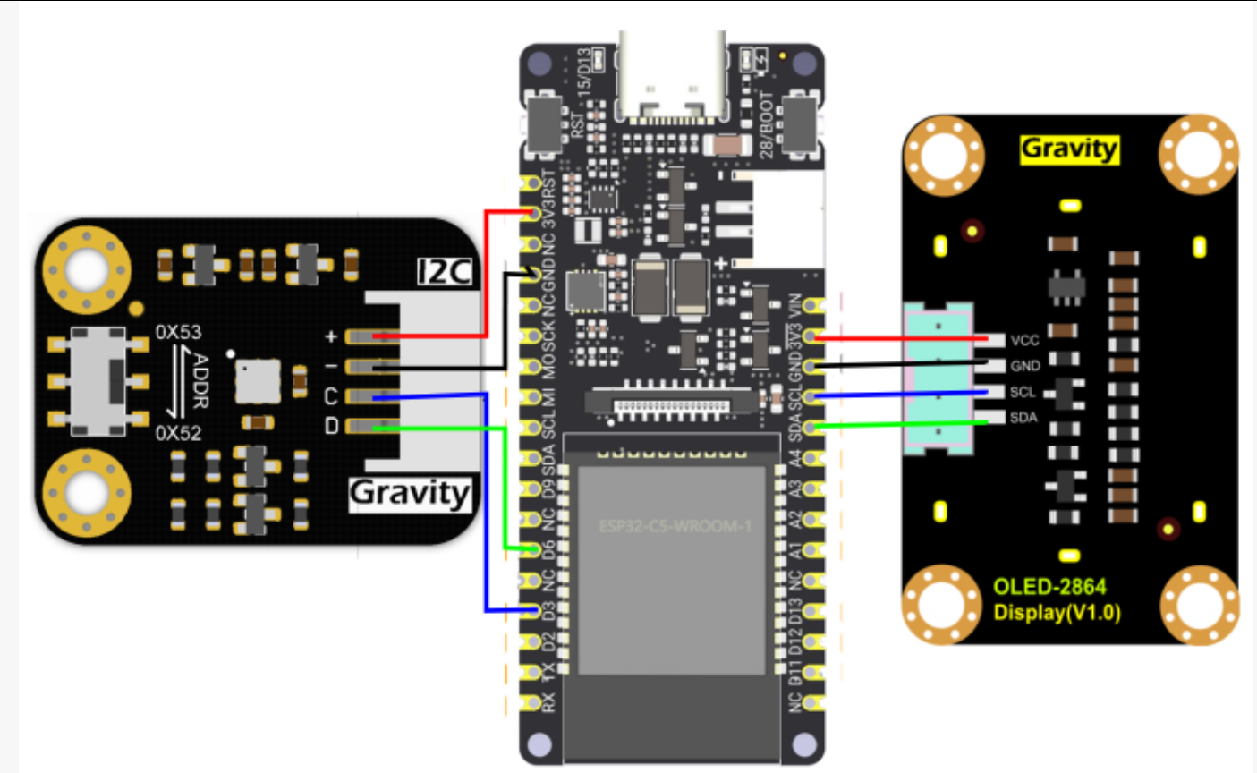

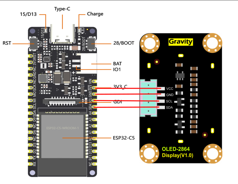

接线:
https://imagemc.dfrobot.com.cn/data/attachment/forum/202510/20/090826kmlmvshv2chsvppy.png

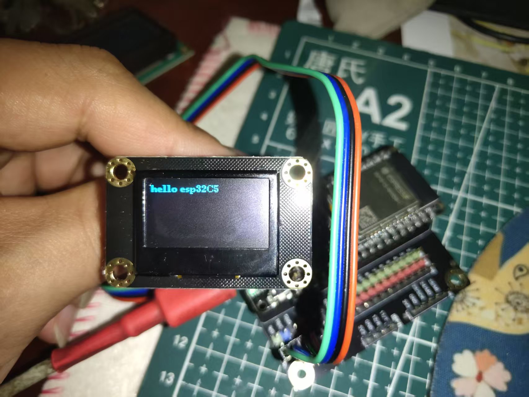

我们用U8g2 Library例程helloWorld
按要求将U8G2_SSD1306_128X64_NONAME_F_SW_I2C u8g2(U8G2_R0, / clock=/ 10, / data=/ 9, / reset=/ 8);前的注释//去掉

void setup(void) {
  u8g2.begin();
void loop(void) {
  u8g2.clearBuffer();                    // clear the internal memory
  u8g2.setFont(u8g2_font_ncenB08_tr);    // choose a suitable font
  u8g2.drawStr(0,10,"hello esp32C3");    // write something to the internal memory
  u8g2.sendBuffer();                    // transfer internal memory to the display
  delay(1000);
效果如下
https://imagemc.dfrobot.com.cn/data/attachment/forum/202510/20/090826v2ptqxo2rwscxwtc.jpeg

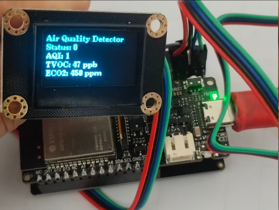

二、串口显示空气质量
1.项目需要的器材有:
1.Firebeetle 2 ESP32 C5 Development Board
2.Gravity ENS160 Air Quality Sensor
3.Gravity I2C OLED-2864显示屏
4.连接线
2.连线
板子和空气质量传感器使用I2C接口连接。

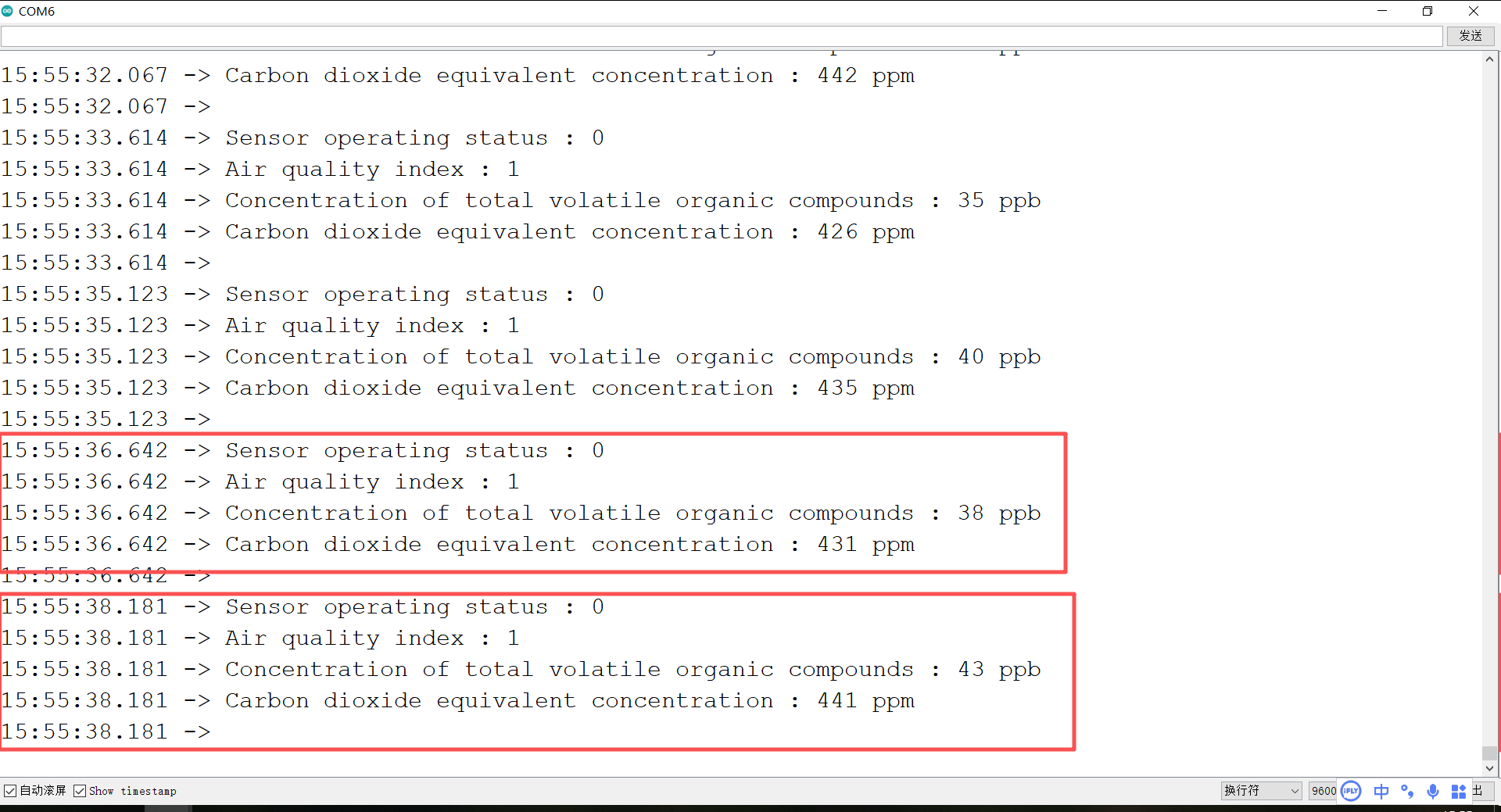

5.串口显示空气质量例程
 * @file  getMeasureData.ino
 * @brief  Get the sensor data by polling (use 3.3V main controller for Fermion version)
 * @details  Configure the sensor power mode and parameters (for compensating the calibrated temperature and relative humidity in gas measurement)
 * @copyright  Copyright (c) 2010 DFRobot Co.Ltd (http://www.dfrobot.com)
 * @license  The MIT License (MIT)
 * @author  [qsjhyy](mailto:yihuan.huang@dfrobot.com)
 * @version  V1.0
 * @date  2021-10-26
 * @url  https://github.com/DFRobot/DFRobot_ENS160
#include <DFRobot_ENS160.h>
#define I2C_COMMUNICATION  //I2C communication. Comment out this line of code if you want to use SPI communication.
#ifdef  I2C_COMMUNICATION
   *   For Fermion version, the default I2C address is 0x53, connect SDO pin to GND and I2C address will be 0x52
  TwoWire myWire(0);
  DFRobot_ENS160_I2C ENS160(&myWire, /*I2CAddr*/ 0x53);
#else
   * Set up digital pin according to the on-board pin connected with SPI chip-select pin
   * csPin Available Pins. For example: ESP32&ESP8266(D3), m0(6)
  uint8_t csPin = D3;
  DFRobot_ENS160_SPI ENS160(&SPI, csPin);
#endif
void setup(void)
  Serial.begin(115200);
  myWire.begin(9,10);
  // Init the sensor
  while( NO_ERR != ENS160.begin() ){
    Serial.println("Communication with device failed, please check connection");
    delay(3000);
  Serial.println("Begin ok!");
   * Set power mode
   * mode Configurable power mode:
   *   ENS160_SLEEP_MODE: DEEP SLEEP mode (low power standby)
   *   ENS160_IDLE_MODE: IDLE mode (low-power)
   *   ENS160_STANDARD_MODE: STANDARD Gas Sensing Modes
  ENS160.setPWRMode(ENS160_STANDARD_MODE);
   * Users write ambient temperature and relative humidity into ENS160 for calibration and compensation of the measured gas data.
   * ambientTemp Compensate the current ambient temperature, float type, unit: C
   * relativeHumidity Compensate the current ambient humidity, float type, unit: %rH
  ENS160.setTempAndHum(/*temperature=*/25.0, /*humidity=*/50.0);
void loop()
   * Get the sensor operating status
   * Return value: 0-Normal operation,
   *         1-Warm-Up phase, first 3 minutes after power-on.
   *         2-Initial Start-Up phase, first full hour of operation after initial power-on. Only once in the sensor’s lifetime.
   * note: Note that the status will only be stored in the non-volatile memory after an initial 24h of continuous
   *       operation. If unpowered before conclusion of said period, the ENS160 will resume "Initial Start-up" mode
   *       after re-powering.
  uint8_t Status = ENS160.getENS160Status();
  Serial.print("Sensor operating status : ");
  Serial.println(Status);
   * Get the air quality index
   * Return value: 1-Excellent, 2-Good, 3-Moderate, 4-Poor, 5-Unhealthy
  uint8_t AQI = ENS160.getAQI();
  Serial.print("Air quality index : ");
  Serial.println(AQI);
   * Get TVOC concentration
   * Return value range: 0–65000, unit: ppb
  uint16_t TVOC = ENS160.getTVOC();
  Serial.print("Concentration of total volatile organic compounds : ");
  Serial.print(TVOC);
  Serial.println(" ppb");
   * Get CO2 equivalent concentration calculated according to the detected data of VOCs and hydrogen (eCO2 – Equivalent CO2)
   * Return value range: 400–65000, unit: ppm
   * Five levels: Excellent(400 - 600), Good(600 - 800), Moderate(800 - 1000),
   *               Poor(1000 - 1500), Unhealthy(> 1500)
  uint16_t ECO2 = ENS160.getECO2();
  Serial.print("Carbon dioxide equivalent concentration : ");
  Serial.print(ECO2);
  Serial.println(" ppm");
  Serial.println();
  delay(1000);
在使用时需要打开串口:工具>USB CDC On Boot: "Enabled">Enabled

串口可以打印出正确的传感器状态、AQI、eCO2/CO2浓度和TVOC的值,结合我们之前驱动屏幕的代码,我们打造一个空气质量检测仪,在oled2864显示器显示所处的空气质量。
核心显示代码如下:
  u8g2.drawStr(0,10,"Air Quality Detector");
  String StatusStr = "Status: " + String(Status) ;
  u8g2.drawStr(0,22,StatusStr.c_str());  // write something to the internal memory
  String aqiStr = "AQI: " + String(AQI) ;
  u8g2.drawStr(0,34,aqiStr.c_str());  // write something to the internal memory
  String tvocStr = "TVOC: " + String(TVOC) + " ppb";
  u8g2.drawStr(0,46,tvocStr.c_str());  // write something to the internal memory
   String ECO2Str = "ECO2: " + String(ECO2) + " ppm";
  u8g2.drawStr(0,58,ECO2Str.c_str());  // write something to the internal memory
  Serial.println();
  delay(1000);
效果如下:
https://imagemc.dfrobot.com.cn/data/attachment/forum/202510/20/090828orurj58kllyqqlyl.png
接线如下:
屏幕接线:
屏幕
esp32 C5 说明
VCC 3.3V 电源
GND GND 接地
SCL 10 I2C时钟线
SDL 9 LCDI2C数据线
空气质量传感器接线:
传感器
esp32 C5 说明
VCC 3.3V 电源
GND GND 接地
SCL 26 I2C时钟线
SDL 27 LCDI2C数据线
如下图所示:
https://imagemc.dfrobot.com.cn/data/attachment/forum/202510/20/090827fj117e61edpokjep.png

总结:
1.使用I2C连接屏幕和空气质量传感器时使用同一个端口后,空气质量传感器输出的值出现莫名的错误。
2.使用例程时掌握I2C接线,避免错误的接线导致程序输出异常。
3.明确传感器和执行器驱动芯片、I2C接口默认接线、默认地址这对于查找错误有很大的帮助。

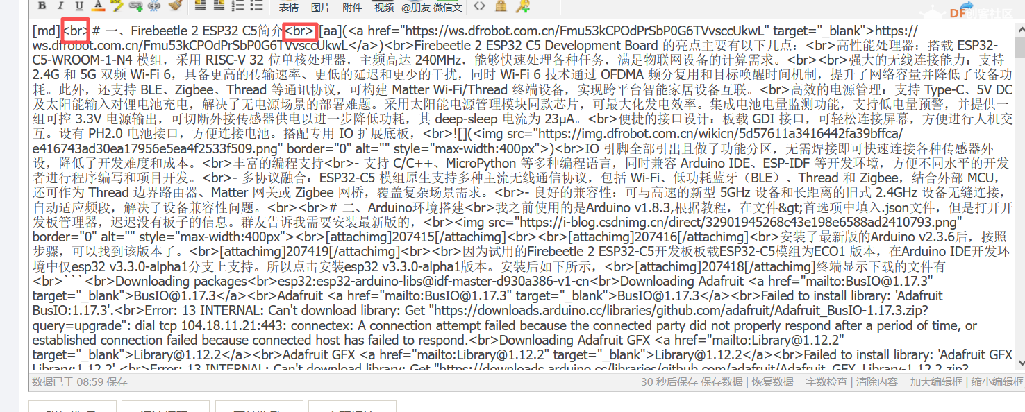

新版本的编辑器快点上吧,创客社区编辑器中踩的坑不少了
1.直接粘贴图片文件点击保存或提交后提示有不良信息不发保存或提交。
2.编辑帖子,多打了回车后,帖子中所有的回车都被强制加了
标签,,有些还是其他html语句,夹杂在md标签里,所有的markdown语句显示不正常。
