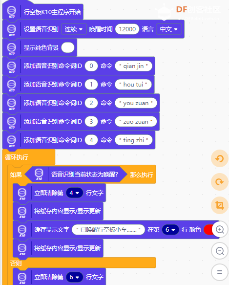

  12. // 主程序开始
  13. void setup() {
  14.         k10.begin();
  15.         asr.asrInit(CONTINUOUS, CN_MODE, 12000);
  16.         while(asr._asrState == 0){delay(100);}
  17.         k10.initScreen(screen_dir);
  18.         k10.creatCanvas();
  19.         asr.setAsrSpeed(2);
  20.         k10.setScreenBackground(0xFFFFFF);
  21.         asr.addASRCommand(0+1, "qian jin");
  22.         asr.addASRCommand(1+1, "hou tui");
  23.         asr.addASRCommand(2+1, "you zuan");
  24.         asr.addASRCommand(3+1, "zuo zuan");
  25.         asr.addASRCommand(4+1, "ting zhi");

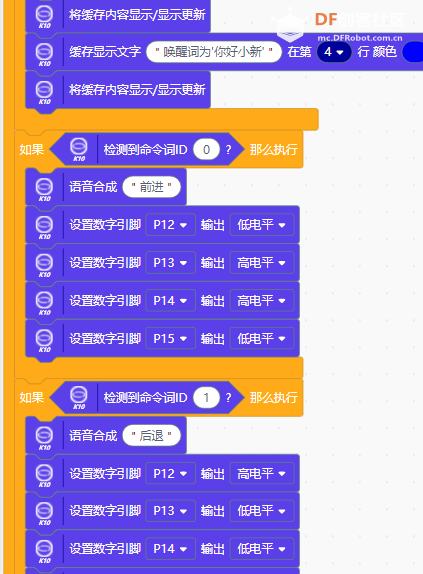

  26. }
  27. void loop() {
  28.         if (asr.isWakeUp()) {
  29.                 k10.canvas->canvasClear(4);
  30.                 k10.canvas->updateCanvas();
  31.                 k10.canvas->canvasText("已唤醒行空板小车.......", 6, 0xFF0000);
  32.                 k10.canvas->updateCanvas();
  33.         }
  34.         else {
  35.                 k10.canvas->canvasClear(6);
  36.                 k10.canvas->updateCanvas();
  37.                 k10.canvas->canvasText("唤醒词为'你好小新'", 4, 0x0000FF);
  38.                 k10.canvas->updateCanvas();
  39.         }

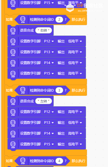

  40.         if (asr.isDetectCmdID(0+1)) {
  41.                 asr.speak("前进");
  42.                 digital_write(eP12, LOW);
  43.                 digital_write(eP13, HIGH);
  44.                 digital_write(eP14, HIGH);
  45.                 digital_write(eP15, LOW);
  46.         }
  47.         if (asr.isDetectCmdID(1+1)) {
  48.                 asr.speak("后退");
  49.                 digital_write(eP12, HIGH);
  50.                 digital_write(eP13, LOW);
  51.                 digital_write(eP14, LOW);
  52.                 digital_write(eP15, HIGH);
  53.         }

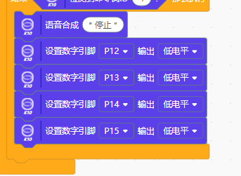

  54.         if (asr.isDetectCmdID(2+1)) {
  55.                 asr.speak("右转");
  56.                 digital_write(eP12, LOW);
  57.                 digital_write(eP13, HIGH);
  58.                 digital_write(eP14, LOW);
  59.                 digital_write(eP15, HIGH);
  60.         }
