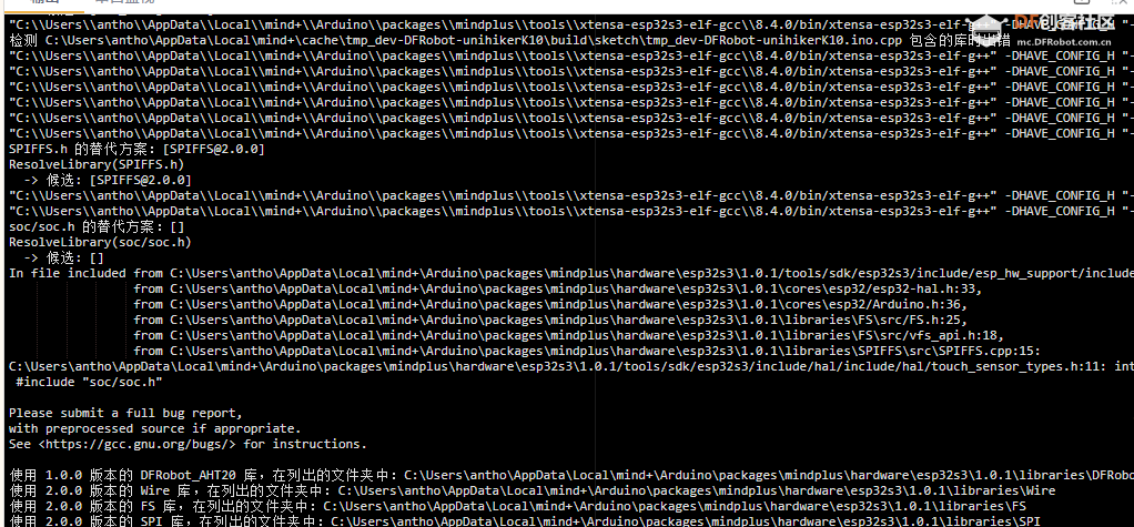

# 2、编译bug
在上传模式下,编译程序时,出现库不存在的情况,但是对应目录下有该文件。所有路径均为英文。且每次出现的错误均不一样。在不修改代码的情况下,多次编译后可能会编译成功。
Mind+ V2.0.5 bug报告,望修复图1Mind+ V2.0.5 bug报告,望修复图2

同样的代码编译多次,每次错误原因都不一样(每次都是错误之后,再次点击上传,没有修改任何代码,拔插硬件):
错误1:
  1. "C:\\Users\\antho\\AppData\\Local\\mind+\\Arduino\\packages\\mindplus\\tools\\xtensa-esp32s3-elf-gcc\\8.4.0/bin/xtensa-esp32s3-elf-g++" -DHAVE_CONFIG_H "-DMBEDTLS_CONFIG_FILE="mbedtls/esp_config.h"" -DUNITY_INCLUDE_CONFIG_H -DWITH_POSIX -D_GNU_SOURCE "-DIDF_VER="v4.4.4"" -DESP_PLATFORM -D_POSIX_READER_WRITER_LOCKS -iprefix "C:\\Users\\antho\\AppData\\Local\\mind+\\Arduino\\packages\\mindplus\\hardware\\esp32s3\\1.0.1/tools/sdk/esp32s3/include/" "@C:\\Users\\antho\\AppData\\Local\\mind+\\Arduino\\packages\\mindplus\\hardware\\esp32s3\\1.0.1/tools/sdk/esp32s3/flags/includes" "-IC:\\Users\\antho\\AppData\\Local\\mind+\\Arduino\\packages\\mindplus\\hardware\\esp32s3\\1.0.1/libraries/lvgl/src" "-IC:\\Users\\antho\\AppData\\Local\\mind+\\Arduino\\packages\\mindplus\\hardware\\esp32s3\\1.0.1/libraries/ESP32_IO_Expander/src" "-IC:\\Users\\antho\\AppData\\Local\\mind+\\Arduino\\packages\\mindplus\\hardware\\esp32s3\\1.0.1/libraries/ESP32_Display_Panel/src" "-IC:\\Users\\antho\\AppData\\Local\\mind+\\Arduino\\packages\\mindplus\\hardware\\esp32s3\\1.0.1/libraries/SD/src" "-IC:\\Users\\antho\\AppData\\Local\\mind+\\Arduino\\packages\\mindplus\\hardware\\esp32s3\\1.0.1/libraries/asr/src" "-IC:\\Users\\antho\\AppData\\Local\\mind+\\Arduino\\packages\\mindplus\\hardware\\esp32s3\\1.0.1/libraries/DFRobot_ESPASR/src" "-IC:\\Users\\antho\\AppData\\Local\\mind+\\Arduino\\packages\\mindplus\\hardware\\esp32s3\\1.0.1/libraries/Adafruit_NeoPixel/src" "-IC:\\Users\\antho\\AppData\\Local\\mind+\\Arduino\\packages\\mindplus\\hardware\\esp32s3\\1.0.1/libraries/unihiker_k10/src" "-IC:\\Users\\antho\\AppData\\Local\\mind+\\cache\\tmp_dev-DFRobot-unihikerK10\\build" "-IC:\\Users\\antho\\AppData\\Local\\mind+\\Arduino\\packages\\mindplus\\hardware\\esp32s3\\1.0.1/tools/sdk/esp32s3/qio_opi/include" -mlongcalls -ffunction-sections -fdata-sections -Wno-error=unused-function -Wno-error=unused-variable -Wno-error=deprecated-declarations -Wno-unused-parameter -Wno-sign-compare -ggdb -freorder-blocks -Wwrite-strings -fstack-protector -fstrict-volatile-bitfields -Wno-error=unused-but-set-variable -fno-jump-tables -fno-tree-switch-conversion -std=gnu++11 -fexceptions -fno-rtti -c -w -Os -w -x c++ -E -CC -DF_CPU=240000000L -DARDUINO=10607 -DARDUINO_esp32s3bit -DARDUINO_ARCH_ESP32S3 "-DARDUINO_BOARD="esp32s3bit"" "-DARDUINO_VARIANT="esp32s3bit"" -DARDUINO_PARTITION_large_spiffs_16MB -DESP32 -DCORE_DEBUG_LEVEL=0 -DARDUINO_RUNNING_CORE=1 -DARDUINO_EVENT_RUNNING_CORE=1 -DBOARD_HAS_PSRAM -DARDUINO_USB_MODE=1 -DARDUINO_USB_CDC_ON_BOOT=1 -DARDUINO_USB_MSC_ON_BOOT=0 -DARDUINO_USB_DFU_ON_BOOT=0 "@C:\\Users\\antho\\AppData\\Local\\mind+\\cache\\tmp_dev-DFRobot-unihikerK10\\build/build_opt.h" "-IC:\\Users\\antho\\AppData\\Local\\mind+\\Arduino\\packages\\mindplus\\hardware\\esp32s3\\1.0.1\\cores\\esp32" "-IC:\\Users\\antho\\AppData\\Local\\mind+\\Arduino\\packages\\mindplus\\hardware\\esp32s3\\1.0.1\\variants\\esp32s3bit" "-IC:\\Users\\antho\\AppData\\Local\\mind+\\Arduino\\packages\\mindplus\\hardware\\esp32s3\\1.0.1\\libraries\\DFRobot_AHT20" "-IC:\\Users\\antho\\AppData\\Local\\mind+\\Arduino\\packages\\mindplus\\hardware\\esp32s3\\1.0.1\\libraries\\Wire\\src" "-IC:\\Users\\antho\\AppData\\Local\\mind+\\Arduino\\packages\\mindplus\\hardware\\esp32s3\\1.0.1\\libraries\\FS\\src" "-IC:\\Users\\antho\\AppData\\Local\\mind+\\Arduino\\packages\\mindplus\\hardware\\esp32s3\\1.0.1\\libraries\\SPI\\src" "-IC:\\Users\\antho\\AppData\\Local\\mind+\\Arduino\\packages\\mindplus\\hardware\\esp32s3\\1.0.1\\libraries\\TFT_eSPI" "-IC:\\Users\\antho\\AppData\\Local\\mind+\\Arduino\\packages\\mindplus\\hardware\\esp32s3\\1.0.1\\libraries\\SPIFFS\\src" "C:\\Users\\antho\\AppData\\Local\\mind+\\cache\\tmp_dev-DFRobot-unihikerK10\\build\\sketch\\tmp_dev-DFRobot-unihikerK10.ino.cpp" -o "C:\\Users\\antho\\AppData\\Local\\mind+\\cache\\tmp_dev-DFRobot-unihikerK10\\build\\preproc\\sketch_merged.cpp"
  2. In file included from C:\Users\antho\AppData\Local\mind+\cache\tmp_dev-DFRobot-unihikerK10\tmp_dev-DFRobot-unihikerK10.ino:6:
  3. C:\Users\antho\AppData\Local\mind+\Arduino\packages\mindplus\hardware\esp32s3\1.0.1/libraries/unihiker_k10/src/unihiker_k10.h:32:10: fatal error: lv_qrcode.h: No such file or directory
  4. #include "lv_qrcode.h"
  5.           ^~~~~~~~~~~~~
  6. compilation terminated.
错误2:
  1. In file included from c:\users\antho\appdata\local\mind+\arduino\packages\mindplus\hardware\esp32s3\1.0.1\libraries\lvgl\src\misc\lv_style.h:22,
  2.                  from c:\users\antho\appdata\local\mind+\arduino\packages\mindplus\hardware\esp32s3\1.0.1\libraries\lvgl\src\draw\lv_draw.h:18,
  3.                  from c:\users\antho\appdata\local\mind+\arduino\packages\mindplus\hardware\esp32s3\1.0.1\libraries\lvgl\src/hal/lv_hal_disp.h:21,
  4.                  from c:\users\antho\appdata\local\mind+\arduino\packages\mindplus\hardware\esp32s3\1.0.1\libraries\lvgl\src/hal/lv_hal.h:16,
  5.                  from c:\users\antho\appdata\local\mind+\arduino\packages\mindplus\hardware\esp32s3\1.0.1\libraries\lvgl\lvgl.h:33,
  6.                  from C:\Users\antho\AppData\Local\mind+\Arduino\packages\mindplus\hardware\esp32s3\1.0.1/libraries/lvgl/src/lvgl.h:17,
  7.                  from C:\Users\antho\AppData\Local\mind+\Arduino\packages\mindplus\hardware\esp32s3\1.0.1/libraries/unihiker_k10/src/unihiker_k10.h:19,
  8.                  from C:\Users\antho\AppData\Local\mind+\cache\tmp_dev-DFRobot-unihikerK10\tmp_dev-DFRobot-unihikerK10.ino:6:
  9. c:\users\antho\appdata\local\mind+\arduino\packages\mindplus\hardware\esp32s3\1.0.1\libraries\lvgl\src\misc\lv_txt.h:23: internal compiler error: Segmentation fault
  10. #include "lv_types.h"
  11. Please submit a full bug report,
  12. with preprocessed source if appropriate.
  13. See <https://gcc.gnu.org/bugs/> for instructions.
  14. 使用 1.0.0 版本的 DFRobot_AHT20 库,在列出的文件夹中:C:\Users\antho\AppData\Local\mind+\Arduino\packages\mindplus\hardware\esp32s3\1.0.1\libraries\DFRobot_AHT20
  15. 使用 2.0.0 版本的 Wire 库,在列出的文件夹中:C:\Users\antho\AppData\Local\mind+\Arduino\packages\mindplus\hardware\esp32s3\1.0.1\libraries\Wire
  16. 使用 2.0.0 版本的 FS 库,在列出的文件夹中:C:\Users\antho\AppData\Local\mind+\Arduino\packages\mindplus\hardware\esp32s3\1.0.1\libraries\FS
  17. 已使用的库         版本    路径
  18. DFRobot_AHT20 1.0.0 C:\Users\antho\AppData\Local\mind+\Arduino\packages\mindplus\hardware\esp32s3\1.0.1\libraries\DFRobot_AHT20
  19. Wire          2.0.0 C:\Users\antho\AppData\Local\mind+\Arduino\packages\mindplus\hardware\esp32s3\1.0.1\libraries\Wire
  20. FS            2.0.0 C:\Users\antho\AppData\Local\mind+\Arduino\packages\mindplus\hardware\esp32s3\1.0.1\libraries\FS
  21. 已使用的平台           版本    路径
  22. mindplus:esp32s3 1.0.1 C:\Users\antho\AppData\Local\mind+\Arduino\packages\mindplus\hardware\esp32s3\1.0.1
  23. 构建时出错:exit status 1
  24. 1
错误3:
  1. 生成函数原型。。。
  2. "C:\\Users\\antho\\AppData\\Local\\mind+\\Arduino\\packages\\mindplus\\tools\\xtensa-esp32s3-elf-gcc\\8.4.0/bin/xtensa-esp32s3-elf-g++" -DHAVE_CONFIG_H "-DMBEDTLS_CONFIG_FILE="mbedtls/esp_config.h"" -DUNITY_INCLUDE_CONFIG_H -DWITH_POSIX -D_GNU_SOURCE "-DIDF_VER="v4.4.4"" -DESP_PLATFORM -D_POSIX_READER_WRITER_LOCKS -iprefix "C:\\Users\\antho\\AppData\\Local\\mind+\\Arduino\\packages\\mindplus\\hardware\\esp32s3\\1.0.1/tools/sdk/esp32s3/include/" "@C:\\Users\\antho\\AppData\\Local\\mind+\\Arduino\\packages\\mindplus\\hardware\\esp32s3\\1.0.1/tools/sdk/esp32s3/flags/includes" "-IC:\\Users\\antho\\AppData\\Local\\mind+\\Arduino\\packages\\mindplus\\hardware\\esp32s3\\1.0.1/libraries/lvgl/src" "-IC:\\Users\\antho\\AppData\\Local\\mind+\\Arduino\\packages\\mindplus\\hardware\\esp32s3\\1.0.1/libraries/ESP32_IO_Expander/src" "-IC:\\Users\\antho\\AppData\\Local\\mind+\\Arduino\\packages\\mindplus\\hardware\\esp32s3\\1.0.1/libraries/ESP32_Display_Panel/src" "-IC:\\Users\\antho\\AppData\\Local\\mind+\\Arduino\\packages\\mindplus\\hardware\\esp32s3\\1.0.1/libraries/SD/src" "-IC:\\Users\\antho\\AppData\\Local\\mind+\\Arduino\\packages\\mindplus\\hardware\\esp32s3\\1.0.1/libraries/asr/src" "-IC:\\Users\\antho\\AppData\\Local\\mind+\\Arduino\\packages\\mindplus\\hardware\\esp32s3\\1.0.1/libraries/DFRobot_ESPASR/src" "-IC:\\Users\\antho\\AppData\\Local\\mind+\\Arduino\\packages\\mindplus\\hardware\\esp32s3\\1.0.1/libraries/Adafruit_NeoPixel/src" "-IC:\\Users\\antho\\AppData\\Local\\mind+\\Arduino\\packages\\mindplus\\hardware\\esp32s3\\1.0.1/libraries/unihiker_k10/src" "-IC:\\Users\\antho\\AppData\\Local\\mind+\\cache\\tmp_dev-DFRobot-unihikerK10\\build" "-IC:\\Users\\antho\\AppData\\Local\\mind+\\Arduino\\packages\\mindplus\\hardware\\esp32s3\\1.0.1/tools/sdk/esp32s3/qio_opi/include" -mlongcalls -ffunction-sections -fdata-sections -Wno-error=unused-function -Wno-error=unused-variable -Wno-error=deprecated-declarations -Wno-unused-parameter -Wno-sign-compare -ggdb -freorder-blocks -Wwrite-strings -fstack-protector -fstrict-volatile-bitfields -Wno-error=unused-but-set-variable -fno-jump-tables -fno-tree-switch-conversion -std=gnu++11 -fexceptions -fno-rtti -c -w -Os -w -x c++ -E -CC -DF_CPU=240000000L -DARDUINO=10607 -DARDUINO_esp32s3bit -DARDUINO_ARCH_ESP32S3 "-DARDUINO_BOARD="esp32s3bit"" "-DARDUINO_VARIANT="esp32s3bit"" -DARDUINO_PARTITION_large_spiffs_16MB -DESP32 -DCORE_DEBUG_LEVEL=0 -DARDUINO_RUNNING_CORE=1 -DARDUINO_EVENT_RUNNING_CORE=1 -DBOARD_HAS_PSRAM -DARDUINO_USB_MODE=1 -DARDUINO_USB_CDC_ON_BOOT=1 -DARDUINO_USB_MSC_ON_BOOT=0 -DARDUINO_USB_DFU_ON_BOOT=0 "@C:\\Users\\antho\\AppData\\Local\\mind+\\cache\\tmp_dev-DFRobot-unihikerK10\\build/build_opt.h" "-IC:\\Users\\antho\\AppData\\Local\\mind+\\Arduino\\packages\\mindplus\\hardware\\esp32s3\\1.0.1\\cores\\esp32" "-IC:\\Users\\antho\\AppData\\Local\\mind+\\Arduino\\packages\\mindplus\\hardware\\esp32s3\\1.0.1\\variants\\esp32s3bit" "-IC:\\Users\\antho\\AppData\\Local\\mind+\\Arduino\\packages\\mindplus\\hardware\\esp32s3\\1.0.1\\libraries\\DFRobot_AHT20" "C:\\Users\\antho\\AppData\\Local\\mind+\\cache\\tmp_dev-DFRobot-unihikerK10\\build\\sketch\\tmp_dev-DFRobot-unihikerK10.ino.cpp" -o "C:\\Users\\antho\\AppData\\Local\\mind+\\cache\\tmp_dev-DFRobot-unihikerK10\\build\\preproc\\sketch_merged.cpp"
  3. In file included from C:\Users\antho\AppData\Local\mind+\Arduino\packages\mindplus\hardware\esp32s3\1.0.1/libraries/unihiker_k10/src/unihiker_k10.h:13,
  4.                  from C:\Users\antho\AppData\Local\mind+\cache\tmp_dev-DFRobot-unihikerK10\tmp_dev-DFRobot-unihikerK10.ino:6:
  5. C:\Users\antho\AppData\Local\mind+\Arduino\packages\mindplus\hardware\esp32s3\1.0.1\libraries\DFRobot_AHT20/DFRobot_AHT20.h:26:10: fatal error: Wire.h: No such file or directory
  6. #include <Wire.h>
  7.           ^~~~~~~~
  8. compilation terminated.

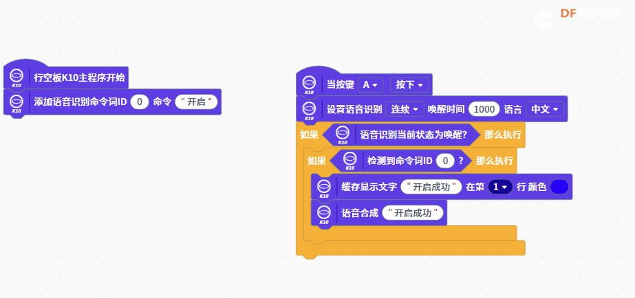

你的mind+版本多少?程序能不能发出来看看?关于用户库看这里https://mindplus.dfrobot.com.cn/ ... y-loading-problems/
