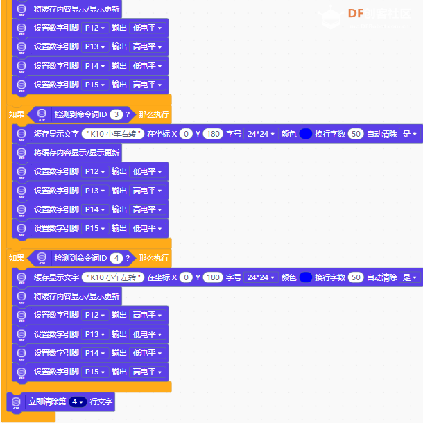

行空板 K10 语音识别小车
* MindPlus
* esp32s3bit
#include "asr.h"
#include "unihiker_k10.h"
// 创建对象
UNIHIKER_K10 k10;
uint8_t      screen_dir=2;
ASR          asr;
// 主程序开始
void setup() {
        k10.begin();
        k10.initScreen(screen_dir);
        k10.creatCanvas();
        asr.asrInit(CONTINUOUS, CN_MODE, 12000);
        k10.setScreenBackground(0xFFFFFF);
        asr.addASRCommand(0+1, "qian jin");
        asr.addASRCommand(1+1, "ting zhi");
        asr.addASRCommand(2+1, "hou tui");
        asr.addASRCommand(3+1, "you zhuan");
        asr.addASRCommand(4+1, "zuo zhuan");
void loop() {
        if (asr.isWakeUp()) {
                k10.canvas->canvasText("以唤醒行空板", 4, 0x33FFFF);
                k10.canvas->updateCanvas();
        else {
                k10.canvas->canvasText("唤醒词为“你好小新”", 7, 0x33FFFF);
        if (asr.isDetectCmdID(0+1)) {
                k10.canvas->canvasText("K10 小车前进", 0, 180, 0x0000FF, k10.canvas->eCNAndENFont24, 50, true);
                digital_write(eP12, HIGH);
                digital_write(eP13, LOW);
                digital_write(eP14, HIGH);
                digital_write(eP15, LOW);
        if (asr.isDetectCmdID(1+1)) {
                k10.canvas->canvasText("K10 小车停止", 0, 180, 0x0000FF, k10.canvas->eCNAndENFont24, 50, true);
                digital_write(eP12, LOW);
                digital_write(eP14, LOW);
        if (asr.isDetectCmdID(2+1)) {
                k10.canvas->canvasText("K10 小车后退", 0, 180, 0x0000FF, k10.canvas->eCNAndENFont24, 50, true);
                digital_write(eP13, HIGH);
                digital_write(eP15, HIGH);
        if (asr.isDetectCmdID(3+1)) {
                k10.canvas->canvasText("K10 小车右转", 0, 180, 0x0000FF, k10.canvas->eCNAndENFont24, 50, true);
        if (asr.isDetectCmdID(4+1)) {
                k10.canvas->canvasText("K10 小车左转", 0, 180, 0x0000FF, k10.canvas->eCNAndENFont24, 50, true);
        k10.canvas->canvasClear(4);
}行空板 K10 语音识别小车图1
