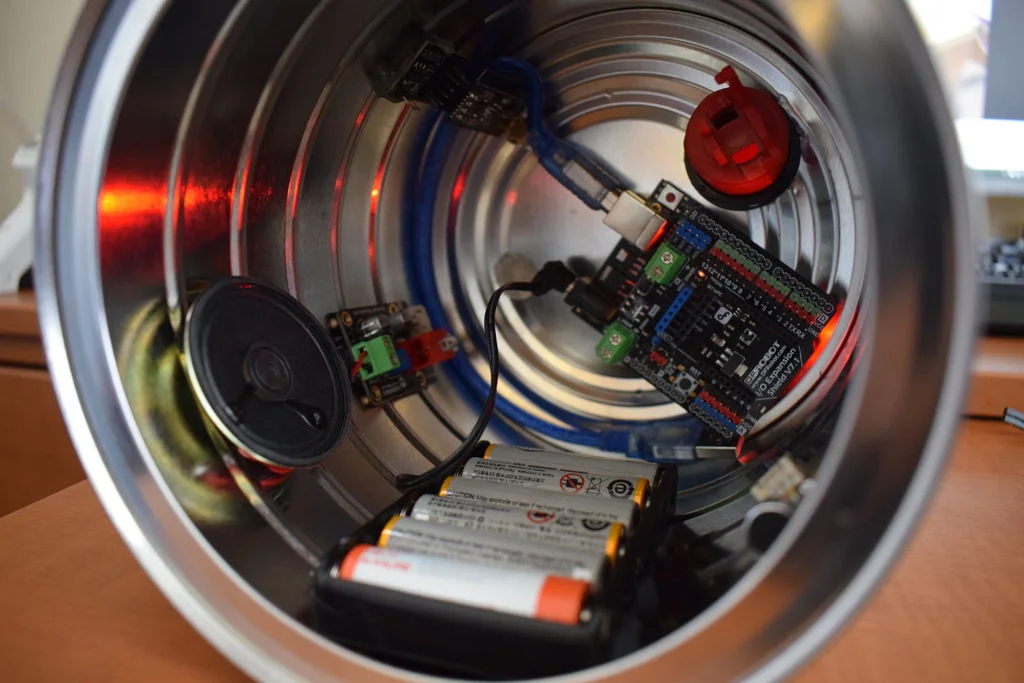

最后的内部结构大概是这个样子:
"表面上是对罐头,其实它是一副对讲机。"图3

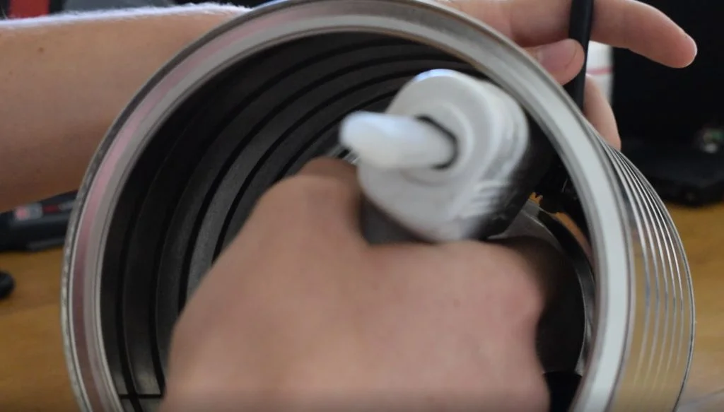

先来给天线钻孔。把天线板放到罐头里面,测量好距离,并用白板笔做好标记,然后在需要钻孔的地方压出一个小凹痕,方便等下钻孔。
根据你使用的天线的不同,需要钻的孔的大小也可能不一样,为了确保尺寸合适,我拿天线上的螺纹和钻头的尺寸进行了比较。
一旦确定好了尺寸、标记好了孔的位置,用电钻快速钻进去,但不要太用力。罐头的壁很薄,钻完之后可以用铁皮剪清理一下孔的边缘,注意手不要被割到。

将DFduino Uno粘到罐子的底部,然后装上电池组。这是所有部件中最重的部分,建议将胶水涂在边缘上,然后把罐子放到你想放的地方,保持天线朝上。
为了方便和美观,我们把扬声器模块粘在电池组的一边,麦克风模块粘在另外一边,像这样:
"表面上是对罐头,其实它是一副对讲机。"图13
这边需要重点强调的一点是一定要多用点胶水,保证没有任何引脚与罐头直接接触。

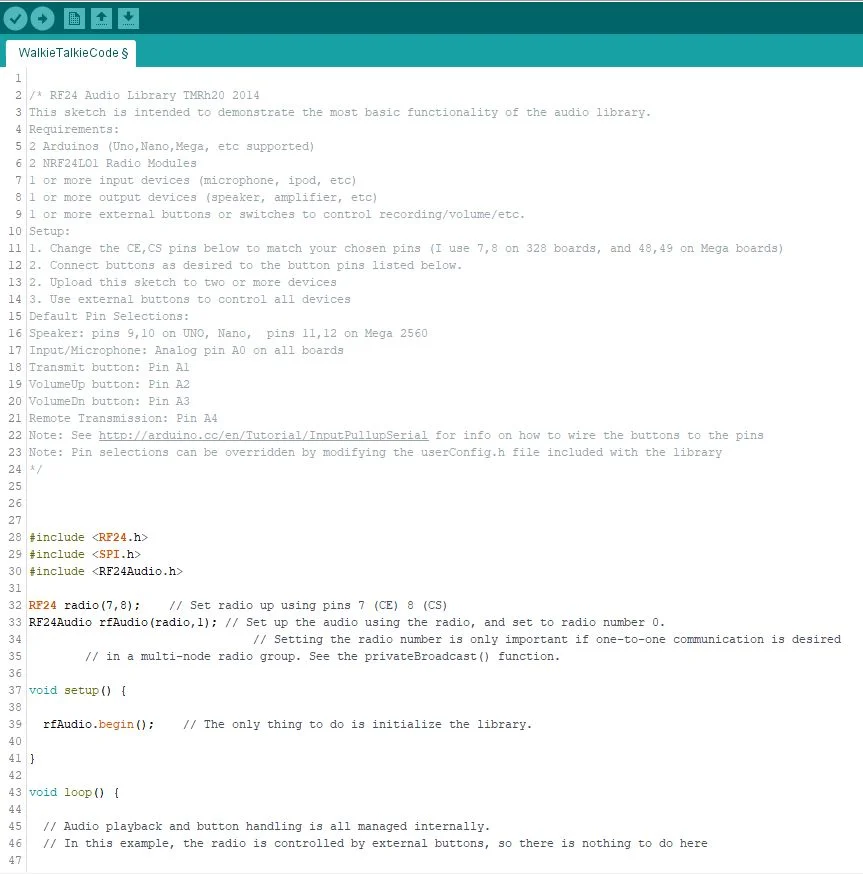

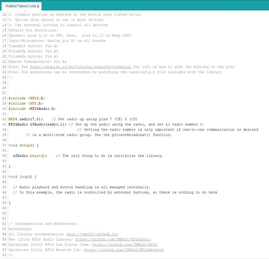

借助RF24Audio库,这个项目的程序非常简单。它甚至不到10行代码!
/* RF24 Audio Library TMRh20 2014
This sketch is intended to demonstrate the most basic functionality of the audio library.
Requirements:
2 Arduinos (Uno,Nano,Mega, etc supported)
2 NRF24LO1 Radio Modules
1 or more input devices (microphone, ipod, etc)
1 or more output devices (speaker, amplifier, etc)
1 or more external buttons or switches to control recording/volume/etc.
Setup:
1. Change the CE,CS pins below to match your chosen pins (I use 7,8 on 328 boards, and 48,49 on Mega boards)
2. Connect buttons as desired to the button pins listed below.
2. Upload this sketch to two or more devices
3. Use external buttons to control all devices
Default Pin Selections:
Speaker: pins 9,10 on UNO, Nano,  pins 11,12 on Mega 2560
Input/Microphone: Analog pin A0 on all boards
Transmit button: Pin A1
VolumeUp button: Pin A2
VolumeDn button: Pin A3
Remote Transmission: Pin A4
Note: See http://arduino.cc/en/Tutorial/InputPullupSerial for info on how to wire the buttons to the pins
Note: Pin selections can be overridden by modifying the userConfig.h file included with the library
#include <RF24.h>
#include <SPI.h>
#include <RF24Audio.h>
RF24 radio(7,8);    // Set radio up using pins 7 (CE) 8 (CS)
RF24Audio rfAudio(radio,1); // Set up the audio using the radio, and set to radio number 0.
                                // Setting the radio number is only important if one-to-one communication is desired
        // in a multi-node radio group. See the privateBroadcast() function.
  rfAudio.begin();    // The only thing to do is initialize the library.
  // Audio playback and button handling is all managed internally.
  // In this example, the radio is controlled by external buttons, so there is nothing to do here
/* Documentation and References:
References:
All Library documentation: http://tmrh20.github.io/
New (2014) RF24 Audio Library: https://github.com/TMRh20/RF24Audio
Optimized (2014) RF24 Lib Source Code: https://github.com/TMRh20/RF24
Optimized (2014) RF24 Network Lib: https://github.com/TMRh20/RF24Network
这里就不具体解释它是如何工作的了,如果你想了解有关Arduino IDE的更多信息以及此代码的含义,请查看此链接
你还需要安装RF24和RF24Audio库,可以在这里下载
安装好Arduino IDE后,下载提供的Arduino程序并打开代码。查看"Tools(工具)"下拉列表。确保将 "Programmer(编程器)" 设置为 AVR ISP,并将 “开发板” 设置为Arduino UNO(或您使用的任何板卡)。还要确认你的端口正确(应该显示"ArduinoUnoonCom#")
现在我们已经准备好烧录代码了。将USB电缆插入Arduino和计算机,然后单击IDE左上方的上载箭头。
代码上传,你可能会听到安静的嗡嗡声。
试着按下按钮,看看嗡嗡声是否会改变音调。
它还应使IO扩展板上的LED变暗。
如果上面的情况都出现了,那么程序正确运行了,说明各个模块的连接也没有问题。
