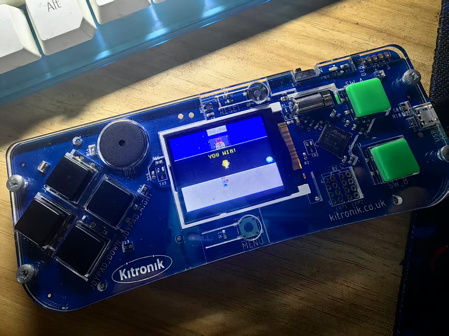

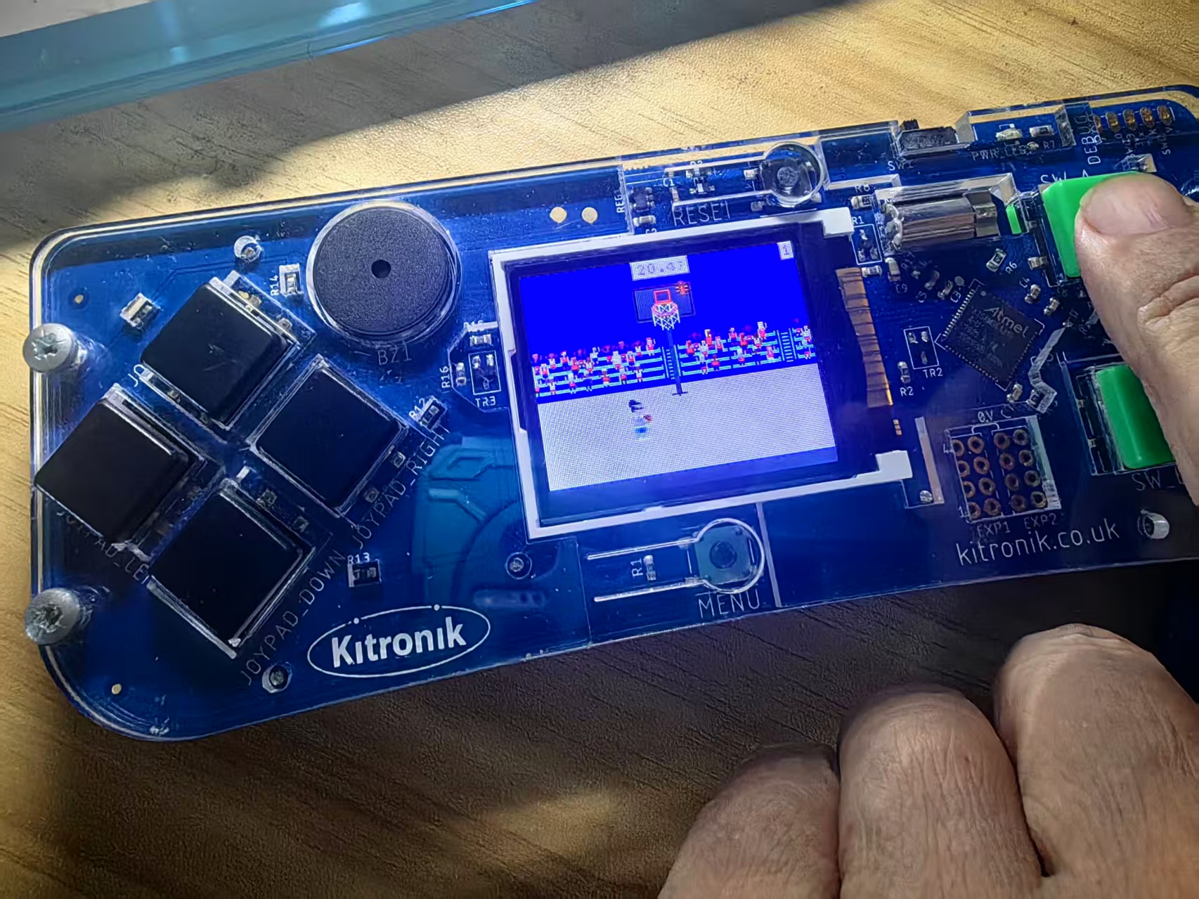

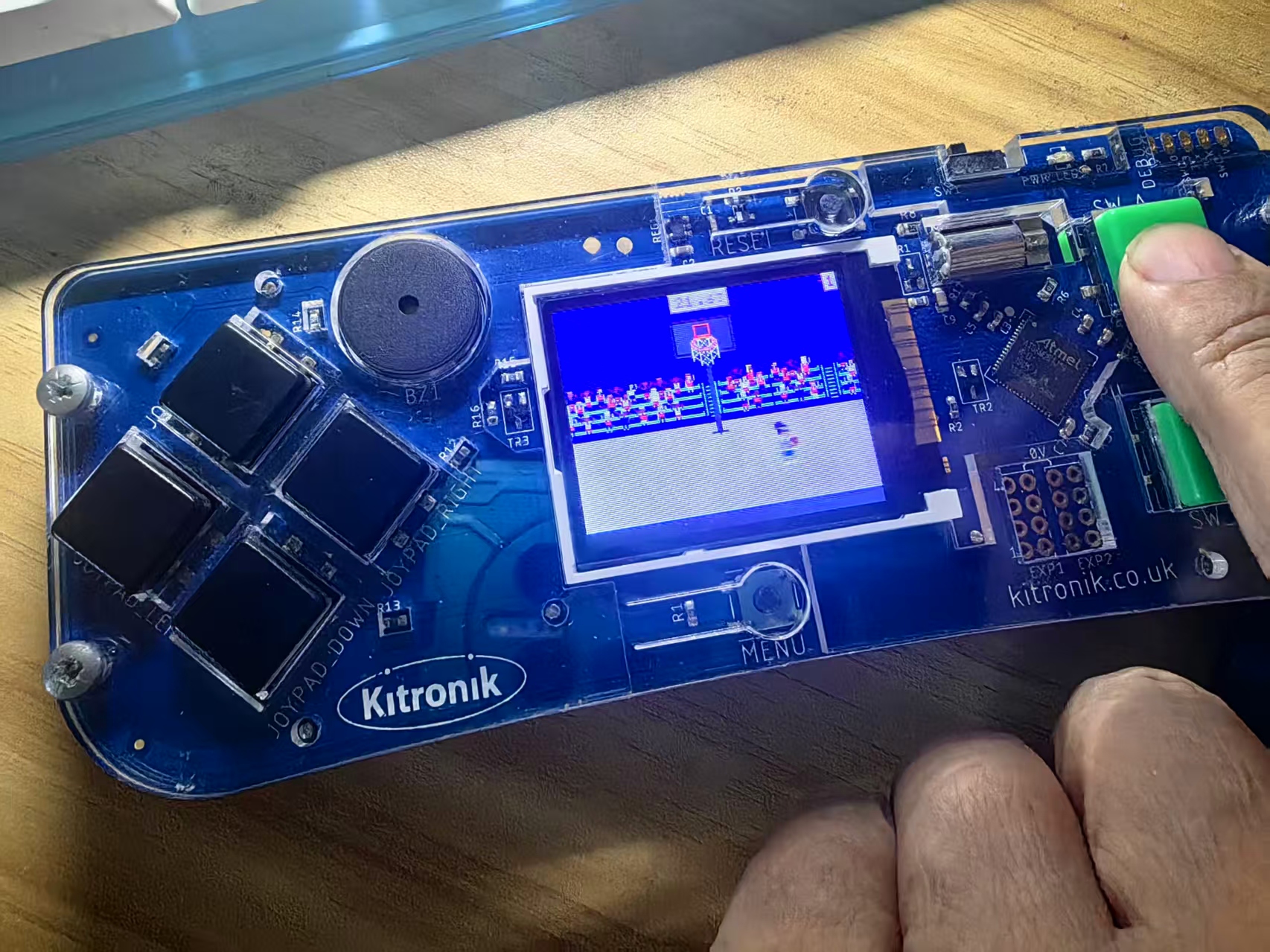

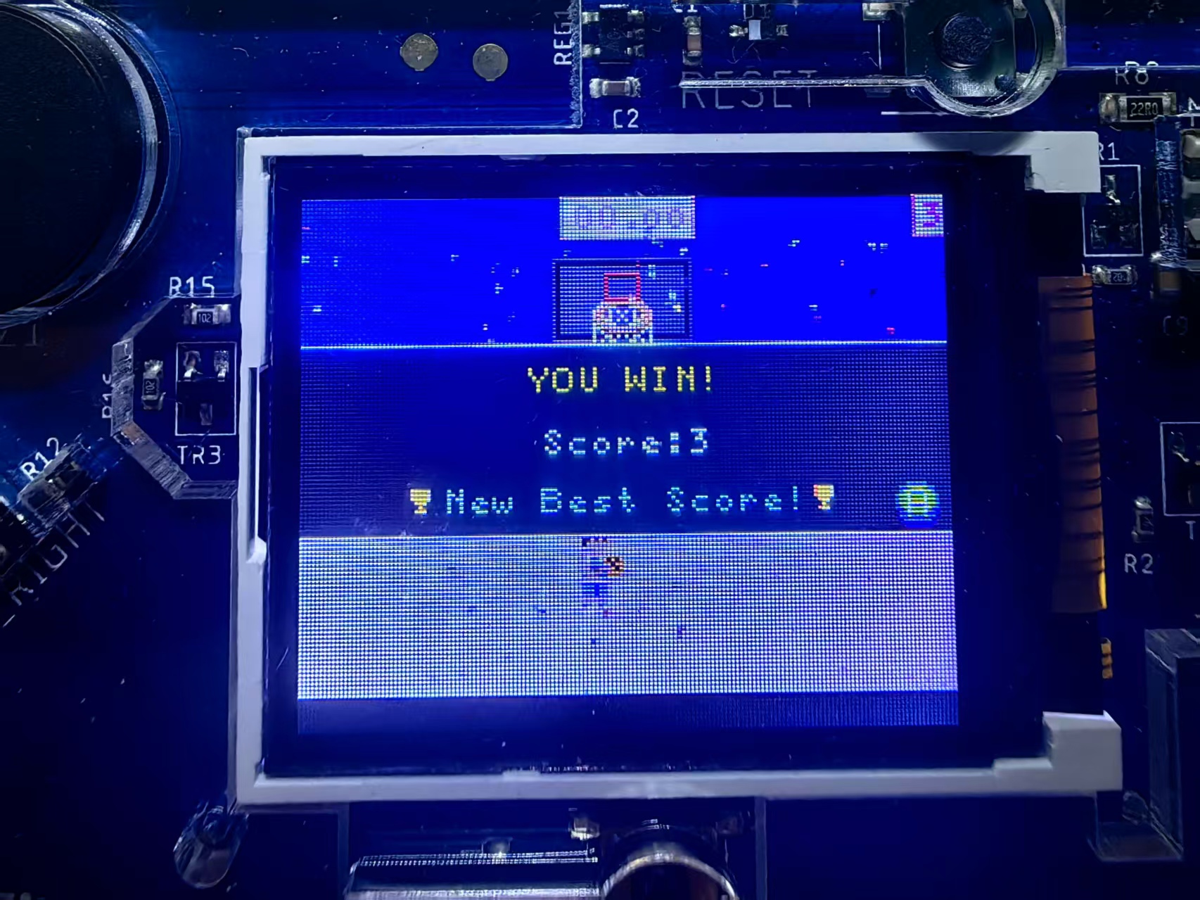

【花雕动手做】基于Kitronik可编程开发板之篮球罚球游戏

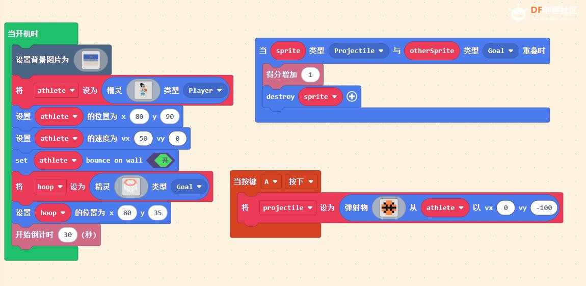

作为学习、练习与尝试,这里创建一个篮球罚球的小游戏。
打开网页版:https://arcade.makecode.com/,设置项目名称:篮球罚球
MicroPython实验参考代码
  1. def on_a_pressed():
  2.     global projectile
  3.     projectile = sprites.create_projectile_from_sprite(throw_imgs.ball, athlete, 0, -100)
  4. controller.A.on_event(ControllerButtonEvent.PRESSED, on_a_pressed)
  5. def on_on_overlap(sprite, otherSprite):
  6.     info.change_score_by(1)
  7.     sprites.destroy(sprite)
  8. sprites.on_overlap(SpriteKind.projectile, SpriteKind.goal, on_on_overlap)
  9. projectile: Sprite = None
  10. athlete: Sprite = None

图形编程参考实验程序
【花雕动手做】基于Kitronik可编程开发板之篮球罚球游戏图1
