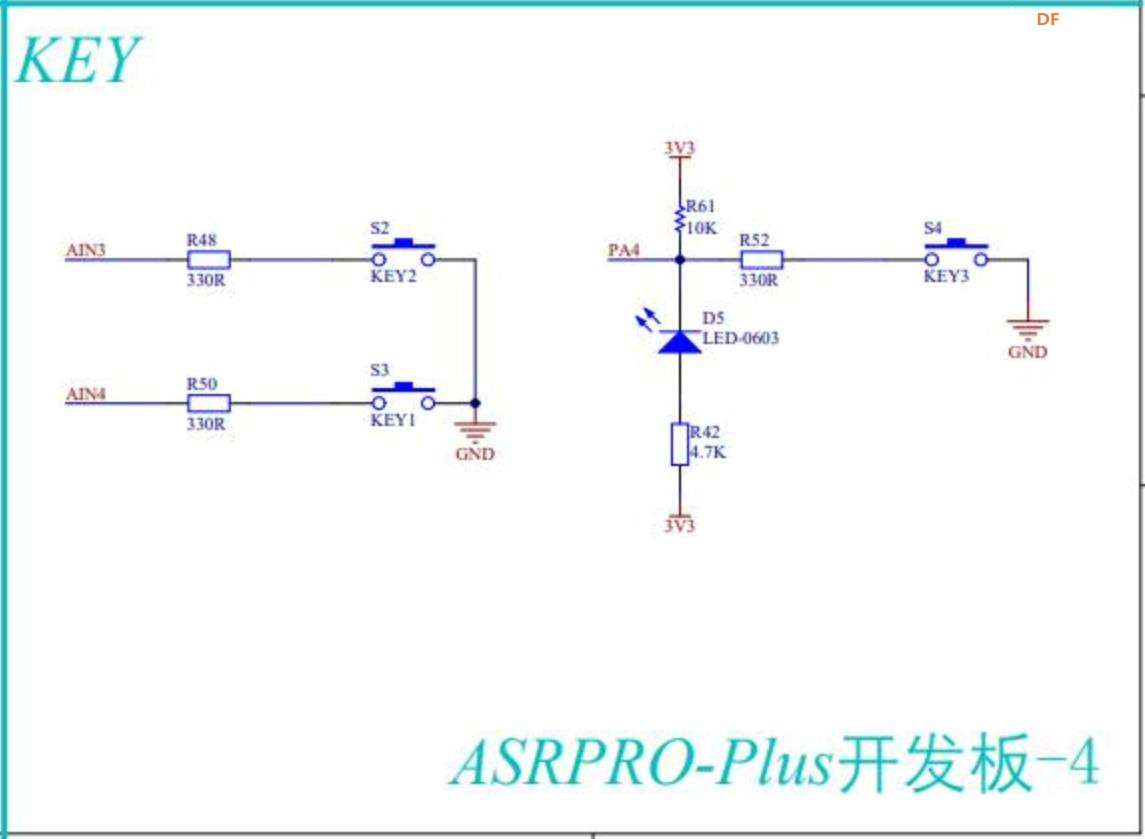

本例实验采用板载三位独立按键,可以搭配实现各种相关的功能。
【花雕动手做】ASRPRO语音识别(49)---尝试使用GPIO口中断图1

电原理图
【花雕动手做】ASRPRO语音识别(49)---尝试使用GPIO口中断图3

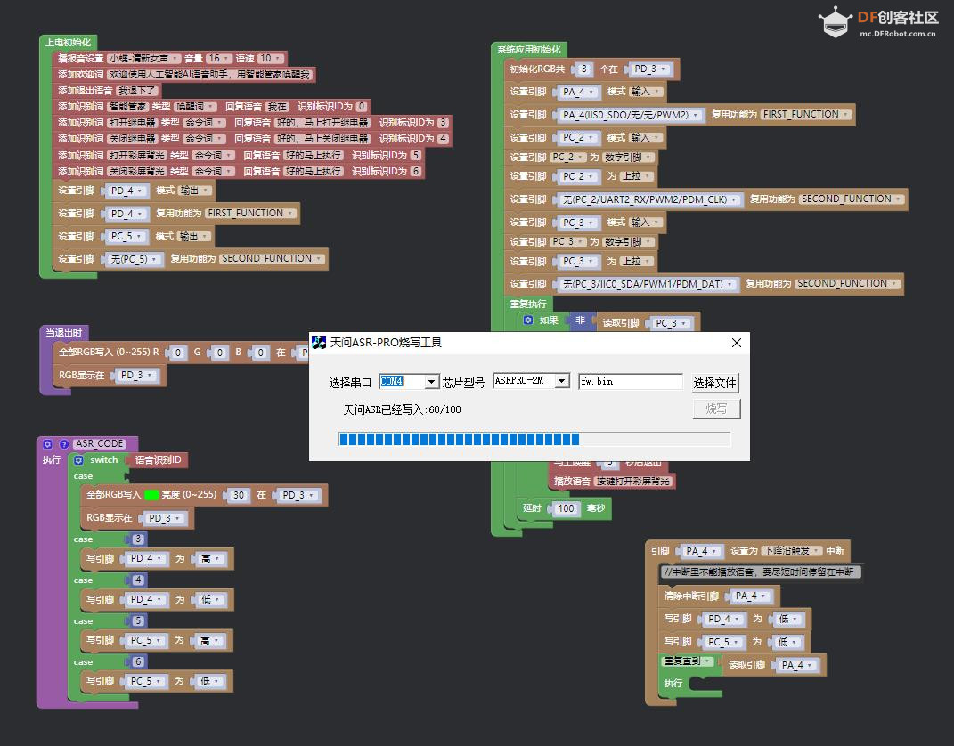

【花雕动手做】实验五十四:测试GPIO口中断和语音来控制继电器与屏幕背光
  1. #include "asr.h"
  2. extern "C"{ void * __dso_handle = 0 ;}
  3. #include "setup.h"
  4. #include "myLib/asr_ws2812.h"
  5. #include "myLib/asr_event.h"
  6. uint32_t snid;
  7. void ASR_CODE();
  8. void hardware_init();
  9. //{ID:250,keyword:"命令词",ASR:"最大音量",ASRTO:"音量调整到最大"}
  10. //{ID:251,keyword:"命令词",ASR:"中等音量",ASRTO:"音量调整到中等"}
  11. //{ID:252,keyword:"命令词",ASR:"最小音量",ASRTO:"音量调整到最小"}
  12. WS2812 ASR_WS2812_27(27);
  13. void sys_sleep_hook()
  14. {
  15.   ASR_WS2812_27.pixel_set_all_color(0,0,0);
  16.   ASR_WS2812_27.pixel_show();
  17. }
  18. /*描述该功能...
  19. */
  20. void ASR_CODE(){
  21.   switch (snid) {
  22.    case NULL:
  23.     ASR_WS2812_27.setBrightness(30);
  24.     ASR_WS2812_27.pixel_set_all_color(0,255,0);
  25.     ASR_WS2812_27.pixel_show();
  26.     break;
  27.    case 3:
  28.     digitalWrite(28,1);
  29.     break;
  30.    case 4:
  31.     digitalWrite(28,0);
  32.     break;
  33.    case 5:
  34.     digitalWrite(21,1);
  35.     break;
  36.    case 6:
  37.     digitalWrite(21,0);
  38.     break;
  39.   }
  40. }
  41. void GPIO0_irq(){
  42.   //中断里不能播放语音,要尽短时间停留在中断
  43.   Clear_GPIO_irq(4);
  44.   digitalWrite(28,0);
  45.   digitalWrite(21,0);
  46.   while (!(digitalRead(4))) {
  47.   }
  48. }
  49. void hardware_init(){
  50.   ASR_WS2812_27.pixel_init(3);
  51.   pinMode(4,input);
  52.   setPinFun(4,FIRST_FUNCTION);
  53.   pinMode(18,input);
  54.   dpmu_set_adio_reuse(PC2,DIGITAL_MODE);
  55.   dpmu_set_io_pull(pinToFun[18],DPMU_IO_PULL_UP);
  56.   setPinFun(18,SECOND_FUNCTION);
  57.   pinMode(19,input);
  58.   dpmu_set_adio_reuse(PC3,DIGITAL_MODE);
  59.   dpmu_set_io_pull(pinToFun[19],DPMU_IO_PULL_UP);
  60.   setPinFun(19,SECOND_FUNCTION);
  61.   while (1) {
  62.     if(!(digitalRead(19))){
  63.       digitalWrite(28,1);
  64.       delay(200);
  65.       enter_wakeup(5000);
  66.       delay(200);
  67.       //{ID:500,keyword:"命令词",ASR:"耍接官",ASRTO:"按键打开继电器"}
  68.       play_audio(500);
  69.     }
  70.     if(!(digitalRead(18))){
  71.       digitalWrite(21,1);
  72.       delay(200);
  73.       enter_wakeup(5000);
  74.       delay(200);
  75.       //{ID:501,keyword:"命令词",ASR:"接耍官",ASRTO:"按键打开彩屏背光"}
  76.       play_audio(501);
  77.     }
  78.     delay(100);
  79.   }
  80.   vTaskDelete(NULL);
  81. }
  82. void setup()
  83. {
  84.   //{speak:小蝶-清新女声,vol:16,speed:10,platform:haohaodada}
  85.   //{playid:10001,voice:欢迎使用人工智能AI语音助手,用智能管家唤醒我}
  86.   //{playid:10002,voice:我退下了}
  87.   //{ID:0,keyword:"唤醒词",ASR:"智能管家",ASRTO:"我在"}
  88.   //{ID:3,keyword:"命令词",ASR:"打开继电器",ASRTO:"好的,马上打开继电器"}
  89.   //{ID:4,keyword:"命令词",ASR:"关闭继电器",ASRTO:"好的,马上关闭继电器"}
  90.   //{ID:5,keyword:"命令词",ASR:"打开彩屏背光",ASRTO:"好的马上执行"}
  91.   //{ID:6,keyword:"命令词",ASR:"关闭彩屏背光",ASRTO:"好的马上执行"}
  92.   pinMode(28,output);
  93.   setPinFun(28,FIRST_FUNCTION);
  94.   pinMode(21,output);
  95.   setPinFun(21,SECOND_FUNCTION);
  96.   pinMode(4,input);
  97.   Set_GPIO_irq(4,down_edges_trigger,GPIO0_irq);
  98.   xTaskCreate(hardware_init,"hardware_init",256,NULL,100,NULL);
  99. }
生成模型与编译烧录
