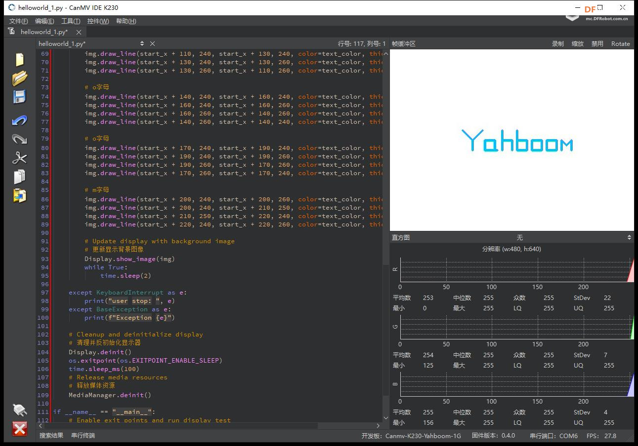

测试实验代码
  1. #【花雕动手做】CanMV K230 AI 视觉识别模块之使用Draw_line方法绘制线条
  2. # 导入系统模块:时间、随机数、系统路径
  3. import time, os, urandom, sys
  4. # 导入显示和媒体处理模块(硬件相关)
  5. from media.display import *  # 显示屏驱动
  6. from media.media import *   # 媒体资源管理
  7. # 定义显示屏分辨率常量(640x480)
  8. DISPLAY_WIDTH = 640
  9. DISPLAY_HEIGHT = 480
  10. def display_test():
  11.     """测试显示功能:用draw_line绘制字母'Yahboom'"""
  12.
  13.     # 1. 创建白色背景图像(ARGB8888格式支持透明度)
  14.     img = image.Image(DISPLAY_WIDTH, DISPLAY_HEIGHT, image.ARGB8888)
  15.     img.clear()  # 清空图像
  16.     img.draw_rectangle(0, 0, DISPLAY_WIDTH, DISPLAY_HEIGHT, color=(255,255,255), fill=True)  # 填充白色
  17.     # 2. 初始化显示屏(ST7701驱动芯片)和媒体管理器
  18.     Display.init(Display.ST7701, width=DISPLAY_WIDTH, height=DISPLAY_HEIGHT, to_ide=True)
  19.     MediaManager.init()
  20.     try:
  21.         # 3. 设置绘制参数:文字颜色(天蓝色)、粗细(5像素)
  22.         thickness = 5
  23.         text_color = (0, 191, 255)  # RGB格式
  24.         # 计算文本起始X坐标(居中显示)
  25.         text_width = 200  # 预估文本总宽度
  26.         start_x = (DISPLAY_WIDTH - text_width) // 2
  27.         # 4. 绘制字母'Y'(通过多条线段组合)
  28.         img.draw_line(start_x, 220, start_x + 20, 240, color=text_color, thickness=thickness)  # 左斜线
  29.         img.draw_line(start_x + 20, 240, start_x + 40, 220, color=text_color, thickness=thickness)  # 右斜线
  30.         img.draw_line(start_x + 20, 240, start_x + 20, 260, color=text_color, thickness=thickness)  # 中竖线
  31.         # 5. 绘制字母'a'(矩形框架)
  32.         img.draw_line(start_x + 45, 240, start_x + 65, 240, color=text_color, thickness=thickness)  # 上横
  33.         img.draw_line(start_x + 65, 240, start_x + 65, 260, color=text_color, thickness=thickness)  # 右竖
  34.         img.draw_line(start_x + 70, 260, start_x + 45, 260, color=text_color, thickness=thickness)  # 下横
  35.         img.draw_line(start_x + 45, 260, start_x + 45, 240, color=text_color, thickness=thickness)  # 左竖
  36.         # 6. 绘制字母'h'(类似'n'但带右侧竖线)
  37.         img.draw_line(start_x + 80, 220, start_x + 80, 260, color=text_color, thickness=thickness)  # 左竖
  38.         img.draw_line(start_x + 80, 240, start_x + 100, 240, color=text_color, thickness=thickness)  # 中横
  39.         img.draw_line(start_x + 100, 240, start_x + 100, 260, color=text_color, thickness=thickness)  # 右竖
  40.         # 7. 绘制字母'b'(类似'd'的左半部分)
  41.         img.draw_line(start_x + 110, 220, start_x + 110, 260, color=text_color, thickness=thickness)  # 左竖
  42.         img.draw_line(start_x + 110, 240, start_x + 130, 240, color=text_color, thickness=thickness)  # 上横
  43.         img.draw_line(start_x + 130, 240, start_x + 130, 260, color=text_color, thickness=thickness)  # 右竖
  44.         img.draw_line(start_x + 130, 260, start_x + 110, 260, color=text_color, thickness=thickness)  # 下横
  45.         # 8. 绘制字母'o'(矩形框)
  46.         img.draw_line(start_x + 140, 240, start_x + 160, 240, color=text_color, thickness=thickness)  # 上横
  47.         img.draw_line(start_x + 160, 240, start_x + 160, 260, color=text_color, thickness=thickness)  # 右竖
  48.         img.draw_line(start_x + 160, 260, start_x + 140, 260, color=text_color, thickness=thickness)  # 下横
  49.         img.draw_line(start_x + 140, 260, start_x + 140, 240, color=text_color, thickness=thickness)  # 左竖
  50.         # 9. 重复绘制'o'(可能是拼写错误,应为'm')
  51.         # ...(此处代码与上一个'o'相同,实际应为'm'的绘制逻辑)
  52.         # 更新显示屏内容
  53.         Display.show_image(img)
  54.
  55.         # 保持显示(循环等待用户中断)
  56.         while True:
  57.             time.sleep(2)
  58.     # 异常处理:用户中断或系统错误
  59.     except KeyboardInterrupt as e:
  60.         print("用户停止:", e)
  61.     except BaseException as e:
  62.         print(f"异常: {e}")
  63.     # 10. 释放资源:反初始化显示屏和媒体管理器
  64.     Display.deinit()
  65.     os.exitpoint(os.EXITPOINT_ENABLE_SLEEP)  # 进入低功耗模式
  66.     time.sleep_ms(100)
  67.     MediaManager.deinit()
  68. # 主程序入口
  69. if __name__ == "__main__":
  70.     os.exitpoint(os.EXITPOINT_ENABLE)  # 启用退出点
  71.     display_test()

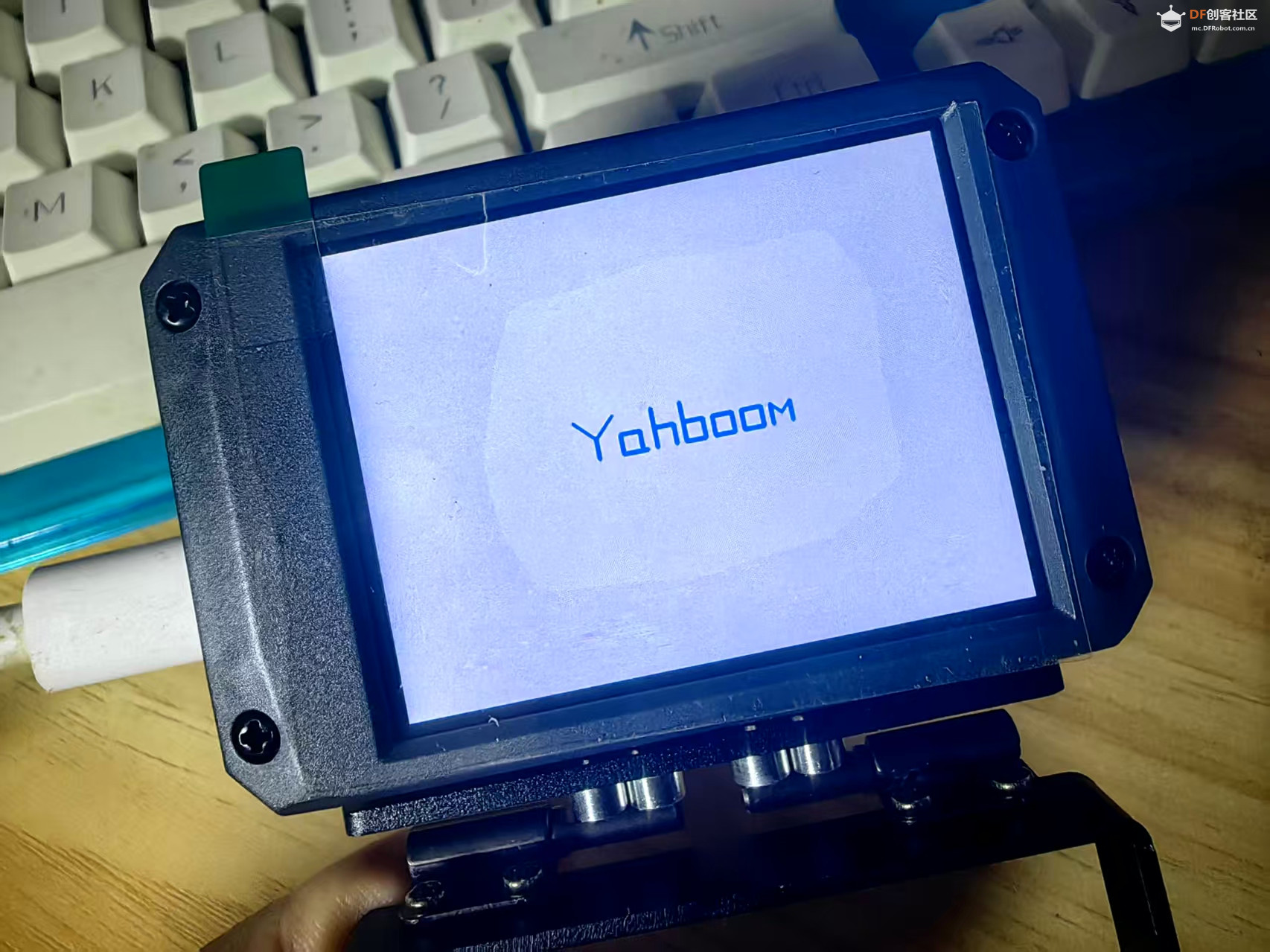

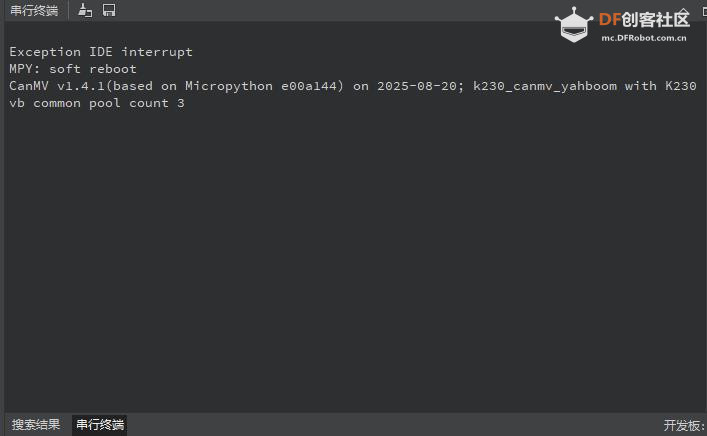

发表于 2025-10-29 11:12:56
【花雕动手做】CanMV K230 AI视觉模块之绘制一个线条LOGO
实验串口返回情况
【花雕动手做】CanMV K230 AI视觉模块之绘制一个线条LOGO图1
实验场景图
【花雕动手做】CanMV K230 AI视觉模块之绘制一个线条LOGO图2
