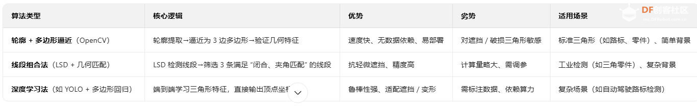

2、主流算法(按场景适配)

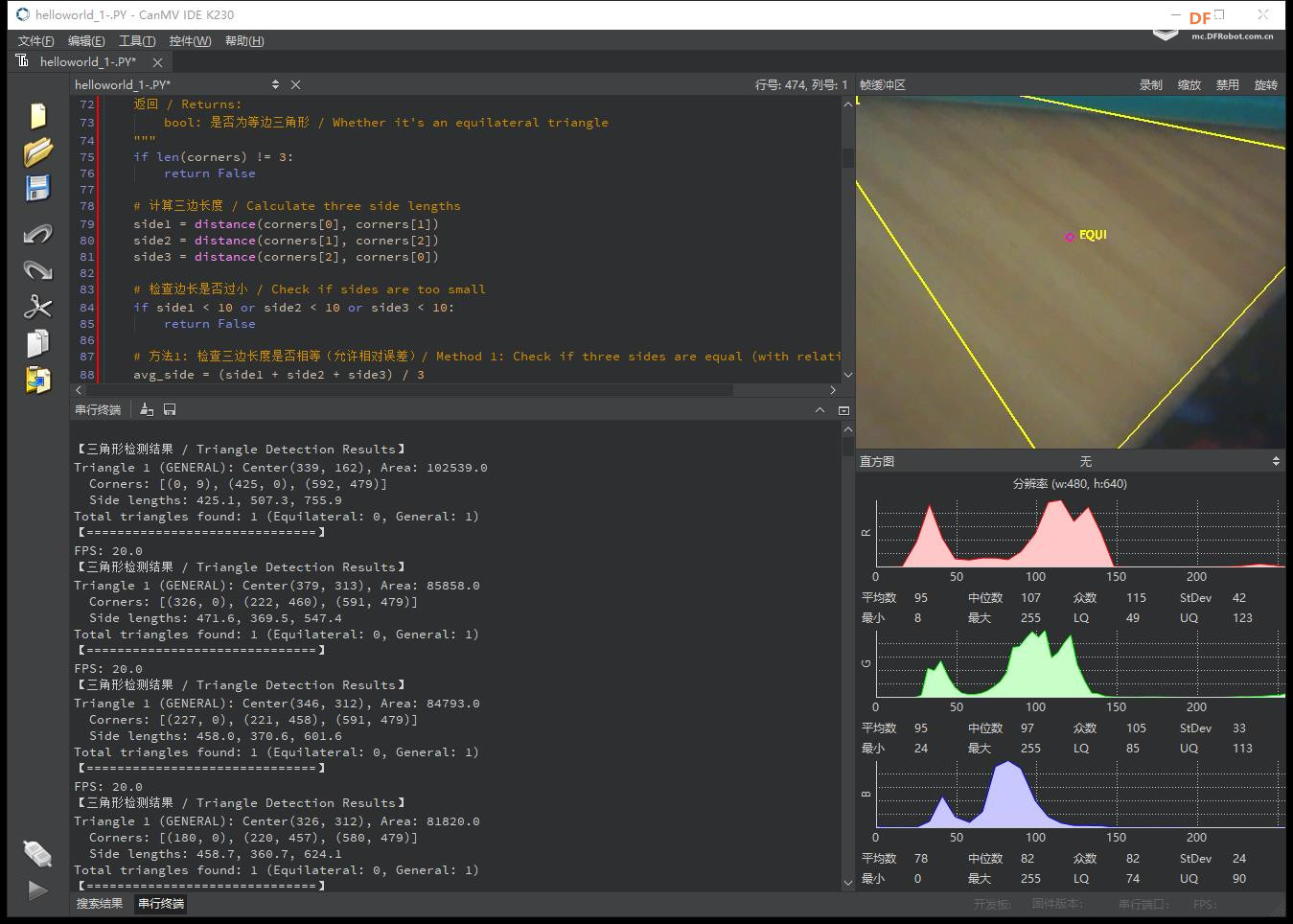

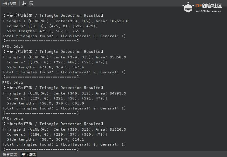

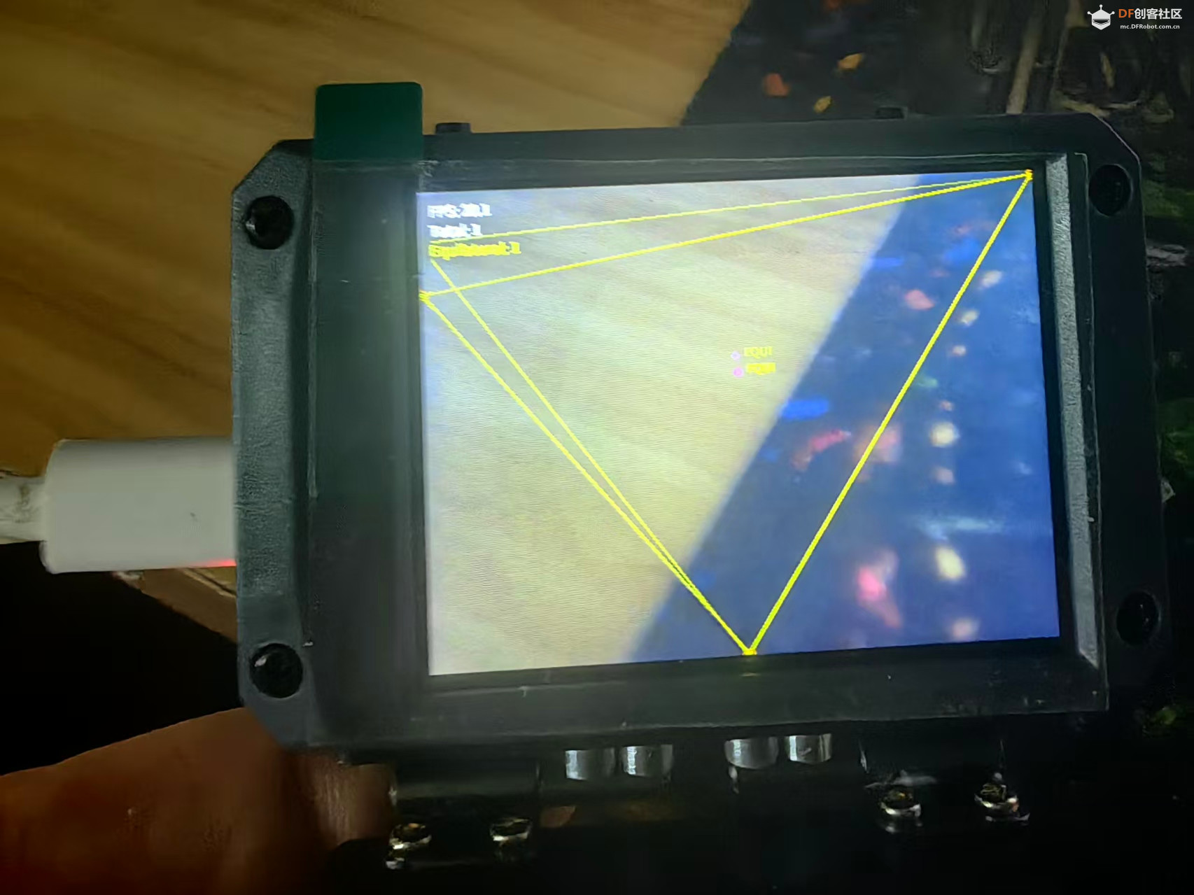

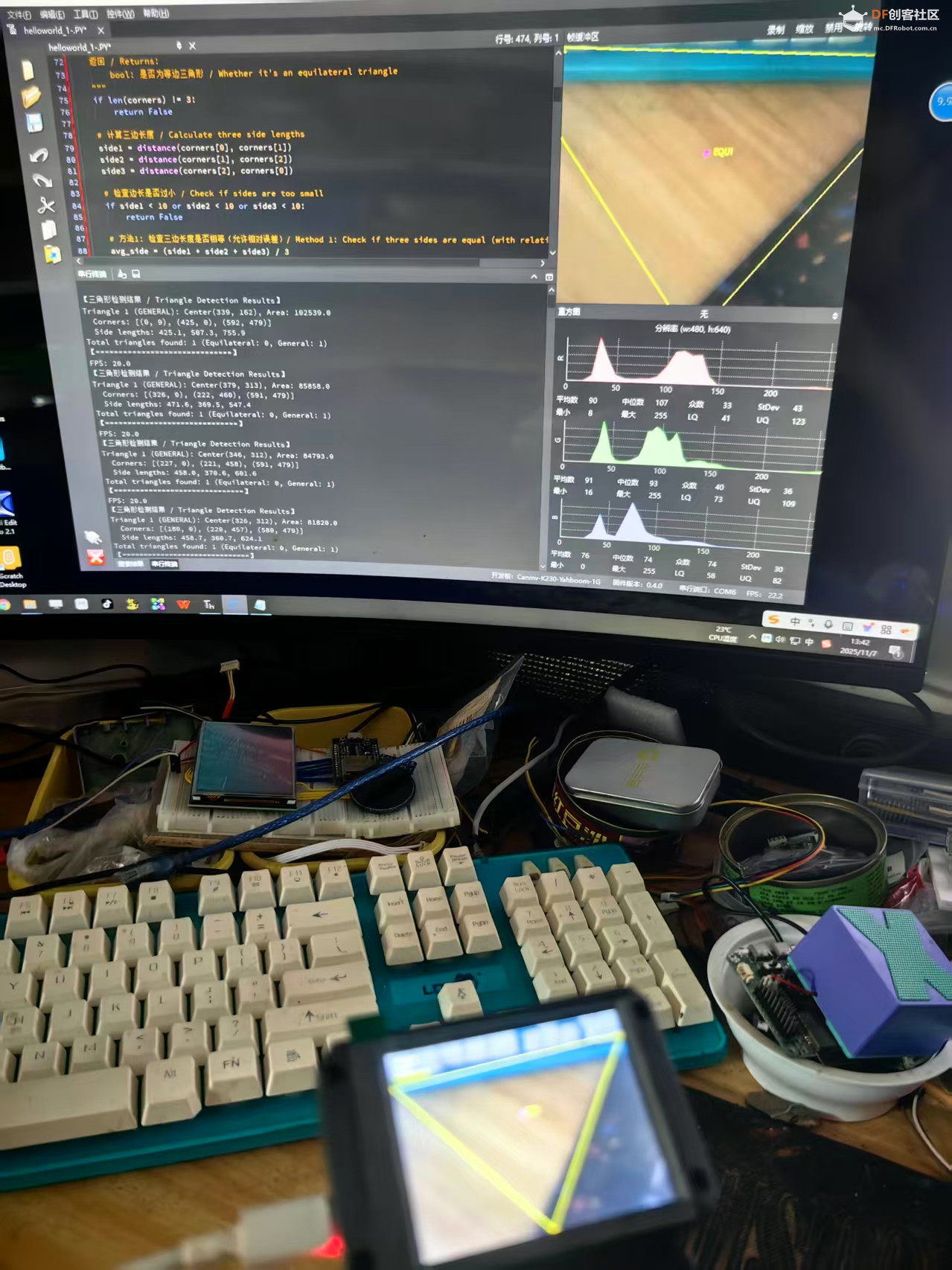

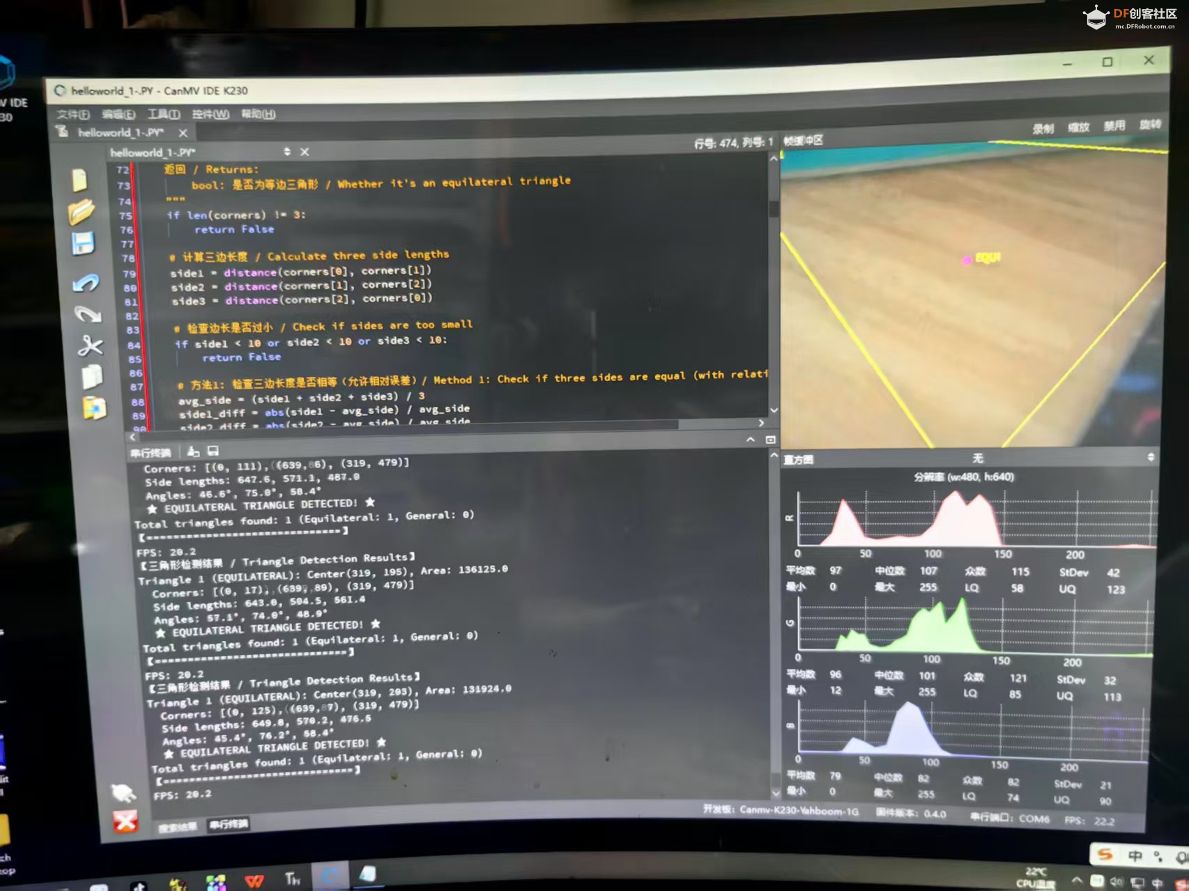

发表于 2025-11-7 13:58:49
【花雕动手做】CanMV K230 AI视觉识别之三角形检测算法
【花雕动手做】CanMV K230 AI 视觉识别模块之优化的三角形检测算法
项目测试实验代码

  134.         rects = img_binary.find_rects(threshold=1000, roi=None)
  135.         for rect in rects:
  136.             corners = rect.corners()
  137.             if corners is not None and len(corners) >= 3:
  138.                 # 尝试所有可能的三点组合 / Try all possible three-point combinations
  139.                 for i in range(len(corners)):
  140.                     for j in range(i+1, len(corners)):
  141.                         for k in range(j+1, len(corners)):
  142.                             triangle_corners = [corners[i], corners[j], corners[k]]
  143.                             if is_valid_triangle(triangle_corners):
  144.                                 center = ((triangle_corners[0][0] + triangle_corners[1][0] + triangle_corners[2][0]) // 3,
  145.                                          (triangle_corners[0][1] + triangle_corners[1][1] + triangle_corners[2][1]) // 3)
  146.                                 area = abs((triangle_corners[1][0] - triangle_corners[0][0]) *
  147.                                           (triangle_corners[2][1] - triangle_corners[0][1]) -
  148.                                           (triangle_corners[2][0] - triangle_corners[0][0]) *
  149.                                           (triangle_corners[1][1] - triangle_corners[0][1])) / 2
  150.                                 # 检查是否为等边三角形 / Check if it's an equilateral triangle
  151.                                 is_equilateral = is_equilateral_triangle(triangle_corners)
  152.                                 triangles.append({
  153.                                     'corners': triangle_corners,
  154.                                     'center': center,
  155.                                     'area': area,
  156.                                     'is_equilateral': is_equilateral,
  157.                                     'type': 'equilateral' if is_equilateral else 'general'
  158.                                 })
  159.                                 break
  160.     except Exception as e:
  161.         pass
  162.     return triangles
  163. def find_triangles_from_blobs(img):
  164.     """
  165.     使用blob检测寻找三角形 / Find triangles using blob detection
  166.     参数 / Parameters:
  167.         img: 输入图像 / Input image
  168.     返回 / Returns:
  169.         list: 检测到的三角形列表 / List of detected triangles
  170.     """
  171.     triangles = []
  172.     try:
  173.         # 检测黑色blob / Detect black blobs
  174.         blobs = img.find_blobs([(0, 50, -128, 127, -128, 127)],
  175.                               pixels_threshold=200,
  176.                               area_threshold=500,
  177.                               merge=True)
  178.         for blob in blobs:
  179.             # 获取blob的边界框 / Get blob bounding box
  180.             x, y, w, h = blob.rect()
  181.             # 检查长宽比是否合理 / Check if aspect ratio is reasonable
  182.             aspect_ratio = max(w, h) / min(w, h)
  183.             if aspect_ratio > 3:  # 过于细长的形状可能不是三角形 / Too elongated shape may not be triangle
  184.                 continue
  185.             # 使用blob的角点信息 / Use blob corner information
  186.             if hasattr(blob, 'corners') and callable(blob.corners):
  187.                 corners = blob.corners()
  188.                 if corners is not None and len(corners) >= 3:
  189.                     # 选择最合适的三个角点 / Select the most suitable three corners
  190.                     best_triangle = None
  191.                     best_score = 0
  192.                     for i in range(len(corners)):
  193.                         for j in range(i+1, len(corners)):
  194.                             for k in range(j+1, len(corners)):
  195.                                 triangle_corners = [corners[i], corners[j], corners[k]]
  196.                                 if is_valid_triangle(triangle_corners):
  197.                                     # 计算三角形质量分数 / Calculate triangle quality score
  198.                                     area = abs((triangle_corners[1][0] - triangle_corners[0][0]) *
  199.                                              (triangle_corners[2][1] - triangle_corners[0][1]) -
  200.                                              (triangle_corners[2][0] - triangle_corners[0][0]) *
  201.                                              (triangle_corners[1][1] - triangle_corners[0][1])) / 2
  202.                                     # 分数基于面积和形状规整度 / Score based on area and shape regularity
  203.                                     score = area
  204.                                     if score > best_score:
  205.                                         best_score = score
  206.                                         best_triangle = triangle_corners
  207.                     if best_triangle:
  208.                         center = ((best_triangle[0][0] + best_triangle[1][0] + best_triangle[2][0]) // 3,
  209.                                  (best_triangle[0][1] + best_triangle[1][1] + best_triangle[2][1]) // 3)
  210.                         # 检查是否为等边三角形 / Check if it's an equilateral triangle
  211.                         is_equilateral = is_equilateral_triangle(best_triangle)
  212.                         triangles.append({
  213.                             'corners': best_triangle,
  214.                             'center': center,
  215.                             'area': best_score,
  216.                             'is_equilateral': is_equilateral,
  217.                             'type': 'equilateral' if is_equilateral else 'general'
  218.                         })
  219.     except Exception as e:
  220.         print(f"Error in blob detection: {e}")
  221.     return triangles
  222. def find_triangles_optimized(img):
  223.     """
  224.     优化的三角形检测主函数 / Optimized main triangle detection function
  225.     参数 / Parameters:
  226.         img: 输入图像 / Input image
  227.     返回 / Returns:
  228.         list: 检测到的三角形列表 / List of detected triangles
  229.     """
  230.     all_triangles = []
  231.     # 方法1: 轮廓检测 / Method 1: Contour detection
  232.     triangles1 = find_triangles_from_contours(img)
  233.     all_triangles.extend(triangles1)
  234.     # 方法2: Blob检测 / Method 2: Blob detection
  235.     triangles2 = find_triangles_from_blobs(img)
  236.     all_triangles.extend(triangles2)
  237.     # 去重和筛选 / Remove duplicates and filter
  238.     unique_triangles = []
  239.     for triangle in all_triangles:
  240.         is_duplicate = False
  241.         for existing in unique_triangles:
  242.             # 检查中心点距离 / Check center point distance
  243.             center_dist = distance(triangle['center'], existing['center'])
  244.             if center_dist < 20:  # 如果中心点很近,认为是重复的 / If centers are close, consider duplicate
  245.                 is_duplicate = True
  246.                 break
  247.         if not is_duplicate:
  248.             unique_triangles.append(triangle)
  249.     # 按面积排序,优先返回较大的三角形 / Sort by area, prioritize larger triangles
  250.     unique_triangles.sort(key=lambda x: x['area'], reverse=True)
  251.     return unique_triangles[:5]  # 最多返回5个三角形 / Return at most 5 triangles
  252. def process_triangles(img, triangles):
  253.     """处理检测到的三角形 / Process detected triangles"""
  254.     print("【三角形检测结果 / Triangle Detection Results】")
  255.     equilateral_count = 0
  256.     general_count = 0
  257.     for i, triangle in enumerate(triangles):
  258.         corners = triangle['corners']
  259.         center = triangle['center']
  260.         area = triangle['area']
  261.         is_equilateral = triangle.get('is_equilateral', False)
  262.         triangle_type = triangle.get('type', 'general')
  263.         # 统计三角形类型 / Count triangle types
  264.         if is_equilateral:
  265.             equilateral_count += 1
  266.         else:
  267.             general_count += 1
  268.         # 根据三角形类型和控制参数决定是否绘制 / Draw based on triangle type and control parameters
  269.         should_draw = False
  270.         if is_equilateral:
  271.             should_draw = True
  272.             line_color = (255, 255, 0)  # 黄色表示等边三角形 / Yellow for equilateral triangles
  273.             corner_color = (255, 165, 0)  # 橙色角点 / Orange corner points
  274.             center_color = (255, 0, 255)  # 紫色中心点 / Purple center point
  275.             label = "EQUI"
  276.         elif DRAW_GENERAL_TRIANGLES:
  277.             should_draw = True
  278.             line_color = (0, 255, 0)  # 绿色表示普通三角形 / Green for general triangles
  279.             corner_color = (255, 0, 0)  # 红色角点 / Red corner points
  280.             center_color = (0, 0, 255)  # 蓝色中心点 / Blue center point
  281.             label = "GEN"
  282.         if should_draw:
  283.             # 绘制三角形边框 / Draw triangle outline
  284.             for j in range(3):
  285.                 start = corners[j]
  286.                 end = corners[(j + 1) % 3]
  287.                 img.draw_line(start[0], start[1], end[0], end[1], color=line_color, thickness=2)
  288.             # 绘制角点 / Draw corner points
  289.             for corner in corners:
  290.                 img.draw_circle(corner[0], corner[1], 4, color=corner_color, thickness=2)
  291.             # 绘制中心点 / Draw center point
  292.             img.draw_circle(center[0], center[1], 3, color=center_color, thickness=2)
  293.             # 在三角形旁边显示类型标签 / Display type label next to triangle
  294.             img.draw_string_advanced(center[0] + 10, center[1] - 10, 12, label, color=line_color, scale=1)
  295.         # 计算边长 / Calculate side lengths
  296.         side1 = distance(corners[0], corners[1])
  297.         side2 = distance(corners[1], corners[2])
  298.         side3 = distance(corners[2], corners[0])
  299.         # 计算三个内角用于验证 / Calculate three angles for verification
  300.         angle1 = calculate_angle(corners[0], corners[1], corners[2])
  301.         angle2 = calculate_angle(corners[1], corners[2], corners[0])
  302.         angle3 = calculate_angle(corners[2], corners[0], corners[1])
  303.         print(f"Triangle {i+1} ({triangle_type.upper()}): Center({center[0]}, {center[1]}), Area: {area:.1f}")
  304.         print(f"  Corners: {corners}")
  305.         print(f"  Side lengths: {side1:.1f}, {side2:.1f}, {side3:.1f}")
  306.         if is_equilateral:
  307.             print(f"  Angles: {angle1:.1f}°, {angle2:.1f}°, {angle3:.1f}°")
  308.             print(f"  ★ EQUILATERAL TRIANGLE DETECTED! ★")
  309.     print(f"Total triangles found: {len(triangles)} (Equilateral: {equilateral_count}, General: {general_count})")
  310.     print("【==============================】")
  311. try:
  312.     # 初始化摄像头 / Initialize camera
  313.     sensor = Sensor()
  314.     sensor.reset()
  315.     # 设置图像分辨率和格式 / Set image resolution and format
  316.     sensor.set_framesize(width=PICTURE_WIDTH, height=PICTURE_HEIGHT, chn=CAM_CHN_ID_0)
  317.     sensor.set_pixformat(Sensor.RGB565, chn=CAM_CHN_ID_0)
  318.     # 初始化显示器 / Initialize display
  319.     if DISPLAY_MODE == "VIRT":
  320.         Display.init(Display.VIRT, width=DISPLAY_WIDTH, height=DISPLAY_HEIGHT, fps=60)
  321.     elif DISPLAY_MODE == "LCD":
  322.         Display.init(Display.ST7701, width=DISPLAY_WIDTH, height=DISPLAY_HEIGHT, to_ide=True)
  323.     # 初始化媒体管理器 / Initialize media manager
  324.     MediaManager.init()
  325.     sensor.run()
  326.     # 计算显示偏移量以居中显示 / Calculate display offsets for center alignment
  327.     x_offset = (DISPLAY_WIDTH - PICTURE_WIDTH) // 2
  328.     y_offset = (DISPLAY_HEIGHT - PICTURE_HEIGHT) // 2
  329.     print("三角形检测已启动,请将黑色三角形放在白色背景前...")
  330.     print("Triangle detection started, please place black triangles on white background...")
  331.     while True:
  332.         os.exitpoint()
  333.         clock.tick()  # 开始计时 / Start timing
  334.         # 捕获图像 / Capture image
  335.         img = sensor.snapshot(chn=CAM_CHN_ID_0)
  336.         # 寻找三角形 / Find triangles
  337.         triangles = find_triangles_optimized(img)
  338.         # 处理检测到的三角形 / Process detected triangles
  339.         equilateral_count = 0
  340.         general_count = 0
  341.         if len(triangles) > 0:
  342.             process_triangles(img, triangles)
  343.             # 统计等边三角形数量 / Count equilateral triangles
  344.             for triangle in triangles:
  345.                 if triangle.get('is_equilateral', False):
  346.                     equilateral_count += 1
  347.                 else:
  348.                     general_count += 1
  349.         # 显示FPS / Display FPS
  350.         fps = clock.fps()
  351.         print(f"FPS: {fps:.1f}")
  352.         # 在图像上显示信息 / Display information on image
  353.         img.draw_string_advanced(10, 10, 15, f"FPS: {fps:.1f}", color=(255, 255, 255), scale=2)
  354.         img.draw_string_advanced(10, 30, 15, f"Total: {len(triangles)}", color=(255, 255, 255), scale=2)
  355.         if equilateral_count > 0:
  356.             img.draw_string_advanced(10, 50, 15, f"Equilateral: {equilateral_count}", color=(255, 255, 0), scale=2)
  357.         if general_count > 0 and DRAW_GENERAL_TRIANGLES:
  358.             img.draw_string_advanced(10, 70, 15, f"General: {general_count}", color=(0, 255, 0), scale=2)
  359.         # 居中显示图像 / Display image centered
  360.         Display.show_image(img, x=x_offset, y=y_offset)
  361. except KeyboardInterrupt as e:
  362.     print("User Stop: ", e)
  363. except BaseException as e:
  364.     print(f"Exception: {e}")
  365. finally:
  366.     # 清理资源 / Cleanup resources
  367.     if isinstance(sensor, Sensor):
  368.         sensor.stop()
  369.     Display.deinit()
  370.     os.exitpoint(os.EXITPOINT_ENABLE_SLEEP)
  371.     time.sleep_ms(100)
  372.     MediaManager.deinit()

发表于 2025-11-7 14:03:55
实验串口返回情况
【花雕动手做】CanMV K230 AI 视觉识别之三角形检测算法图1
实验场景图
【花雕动手做】CanMV K230 AI 视觉识别之三角形检测算法图2
【花雕动手做】CanMV K230 AI 视觉识别之三角形检测算法图3
【花雕动手做】CanMV K230 AI 视觉识别之三角形检测算法图5
【花雕动手做】CanMV K230 AI 视觉识别之三角形检测算法图4
