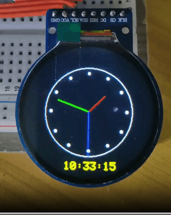

发表于 2025-4-17 10:05:26
【花雕学编程】Arduino动手做(249)--GC9A01指针与数字时钟
  项目之一百零三:GC9A01园屏之模拟动态指针与数字时钟
  1. /*
  4.   项目之一百零三:GC9A01园屏之模拟动态指针与数字时钟
  5. */
  14. #include "SPI.h"
  15. #include "Adafruit_GFX.h"
  16. #include "Adafruit_GC9A01A.h"
  17. #define TFT_CS 4
  18. #define TFT_DC 2
  19. #define TFT_RST -1
  20. Adafruit_GC9A01A tft = Adafruit_GC9A01A(TFT_CS, TFT_DC, TFT_RST);
  21. #define SCREEN_WIDTH 240
  22. #define SCREEN_HEIGHT 240
  23. #define CENTER_X SCREEN_WIDTH / 2
  24. #define CENTER_Y SCREEN_HEIGHT / 2
  25. #define CLOCK_RADIUS 80
  26. #define TEXT_SIZE 2
  27. int simulatedSeconds = 0;
  28. int simulatedMinutes = 30;
  29. int simulatedHours = 10;
  30. void setup() {
  31.     Serial.begin(115200);
  32.     tft.begin();
  33.     tft.setRotation(2);
  34.     tft.fillScreen(tft.color565(0, 0, 0));
  35. }
  36. void drawClockFace() {
  37.     tft.fillScreen(tft.color565(0, 0, 0));
  38.     // **绘制表盘**
  39.     tft.drawCircle(CENTER_X, CENTER_Y, CLOCK_RADIUS, tft.color565(255, 255, 255));
  40.     for (int i = 0; i < 12; i++) {
  41.         float angle = i * 30 * M_PI / 180;
  42.         int x = CENTER_X + cos(angle) * (CLOCK_RADIUS - 10);
  43.         int y = CENTER_Y + sin(angle) * (CLOCK_RADIUS - 10);
  44.         tft.fillCircle(x, y, 2, tft.color565(255, 255, 255));
  45.     }
  46. }
  47. void drawHands() {
  48.     float hourAngle = (simulatedHours % 12 + simulatedMinutes / 60.0) * 30 * M_PI / 180;
  49.     float minuteAngle = (simulatedMinutes + simulatedSeconds / 60.0) * 6 * M_PI / 180;
  50.     float secondAngle = simulatedSeconds * 6 * M_PI / 180;
  51.     // **绘制时针**
  52.     tft.drawLine(CENTER_X, CENTER_Y, CENTER_X + cos(hourAngle) * (CLOCK_RADIUS - 40), CENTER_Y + sin(hourAngle) * (CLOCK_RADIUS - 40), tft.color565(255, 0, 0));
  53.     // **绘制分针**
  54.     tft.drawLine(CENTER_X, CENTER_Y, CENTER_X + cos(minuteAngle) * (CLOCK_RADIUS - 20), CENTER_Y + sin(minuteAngle) * (CLOCK_RADIUS - 20), tft.color565(0, 255, 0));
  55.     // **绘制秒针**
  56.     tft.drawLine(CENTER_X, CENTER_Y, CENTER_X + cos(secondAngle) * CLOCK_RADIUS, CENTER_Y + sin(secondAngle) * CLOCK_RADIUS, tft.color565(0, 0, 255));
  57. }
  58. void drawDigitalClock() {
  59.     char timeString[10];
  60.     sprintf(timeString, "%02d:%02d:%02d", simulatedHours, simulatedMinutes, simulatedSeconds);
  61.     tft.setTextColor(tft.color565(255, 255, 0));
  62.     tft.setTextSize(TEXT_SIZE);
  63.     tft.setCursor(76, 210);
  64.     tft.print(timeString);
  65. }
  66. void loop() {
  67.     simulatedSeconds++;
  68.     if (simulatedSeconds >= 60) {
  69.         simulatedSeconds = 0;
  70.         simulatedMinutes++;
  71.         if (simulatedMinutes >= 60) {
  72.             simulatedMinutes = 0;
  73.             simulatedHours++;
  74.             if (simulatedHours >= 12) {
  75.                 simulatedHours = 0;
  76.             }
  77.         }
  78.     }
  79.     drawClockFace();
  80.     drawHands();
  81.     drawDigitalClock();
  82.     delay(1000);
  83. }
发表于 2025-4-17 10:06:43
这段代码模拟了一个动态时钟,它不依赖时间模块,而是通过计算秒、分、时的变化,每秒更新一次,使指针不断旋转。
代码结构
1️⃣ 初始化屏幕
• 使用 Adafruit_GC9A01A 驱动 TFT 屏幕,并设定黑色背景。
2️⃣ 绘制表盘
• drawClockFace() 绘制 圆形时钟外框 和 12个刻度点。
3️⃣ 绘制指针
• drawHands() 计算 时针、分针、秒针的角度 并绘制动态指针。
• cos() 和 sin() 计算旋转角度,使指针正确指向时间。
4️⃣ 模拟时间流动
• simulatedSeconds++ 模拟每秒时间变化,并自动调整分、小时数。
• 当 秒数达到 60 时,自动更新分钟;分钟达到 60 时,更新小时。
5️⃣ 数字时钟显示
• drawDigitalClock() 在屏幕底部显示 当前时间,同步指针变化。
6️⃣ 持续循环
• delay(1000); 让时钟 每秒刷新一次,保持动画流畅。
最终效果
屏幕显示一个模拟时钟,指针和数字时间同步变化
表盘美观,增强视觉体验
每秒更新,让动画流畅自然
发表于 2025-4-17 10:10:54
