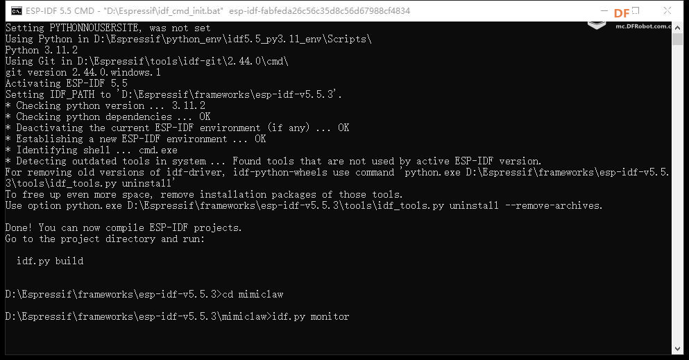

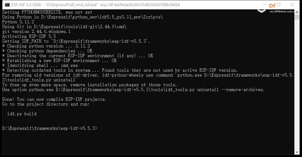

ESP32S3连接电脑,打开ESP-IDF 5.5 的CMD
【花雕】超全整理:嵌入式 AI 调试MimicLaw命令速查手册图1

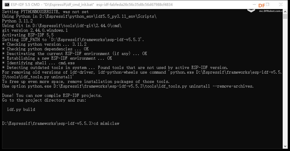

输入 cd mimiclaw 命令,进入mimiclaw项目
【花雕】超全整理:嵌入式 AI 调试MimicLaw命令速查手册图2

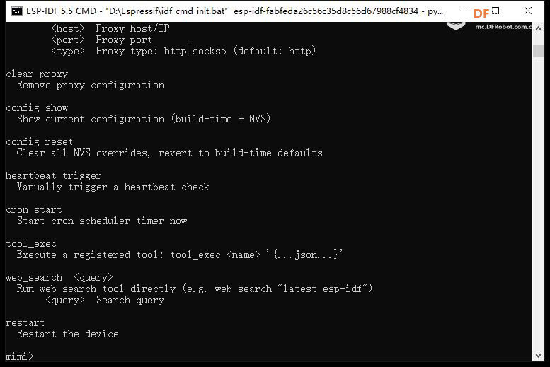

输入idf.py monitor命令,进入项目串口监视器
【花雕】超全整理:嵌入式 AI 调试MimicLaw命令速查手册图3
【花雕】超全整理:嵌入式 AI 调试MimicLaw命令速查手册图4

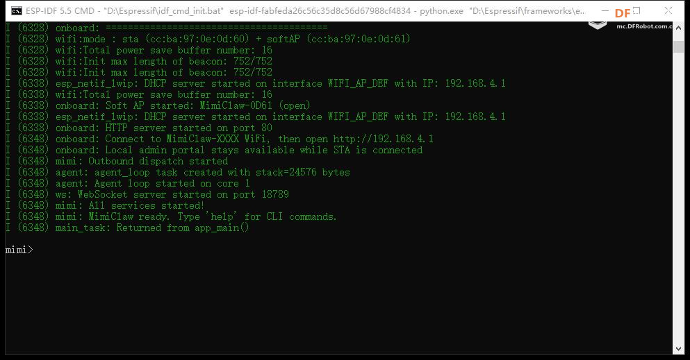

进入后,串口监视器会给出一份长长的 mimiclaw 启动日志
全文启动日志如下

  173. I (4458) wifi:state: auth -> assoc (0x0)
  174. I (4478) wifi:state: assoc -> run (0x10)
  175. I (4628) wifi:connected with zhz3, aid = 2, channel 7, BW20, bssid = 3c:cd:57:69:0f:3a
  176. I (4628) wifi:security: WPA2-PSK, phy: bgn, rssi: -37
  177. I (4628) wifi:pm start, type: 1
  178. I (4628) wifi:dp: 1, bi: 102400, li: 3, scale listen interval from 307200 us to 307200 us
  179. I (4628) wifi:set rx beacon pti, rx_bcn_pti: 0, bcn_timeout: 25000, mt_pti: 0, mt_time: 10000
  180. I (4708) wifi:AP's beacon interval = 102400 us, DTIM period = 1
  181. I (5128) wifi:<ba-add>idx:0 (ifx:0, 3c:cd:57:69:0f:3a), tid:0, ssn:2, winSize:64
  182. I (6328) esp_netif_handlers: sta ip: 192.168.28.161, mask: 255.255.255.0, gw: 192.168.28.1
  183. I (6328) wifi: Connected! IP: 192.168.28.161
  184. I (6328) mimi: WiFi connected: 192.168.28.161
  185. I (6328) onboard: ========================================
  186. I (6328) onboard:   Starting WiFi Configuration Portal
  187. I (6328) onboard: ========================================
  188. I (6328) wifi:mode : sta (cc:ba:97:0e:0d:60) + softAP (cc:ba:97:0e:0d:61)
  189. I (6328) wifi:Total power save buffer number: 16
  190. I (6328) wifi:Init max length of beacon: 752/752
  191. I (6328) wifi:Init max length of beacon: 752/752
  192. I (6338) esp_netif_lwip: DHCP server started on interface WIFI_AP_DEF with IP: 192.168.4.1
  193. I (6338) wifi:Total power save buffer number: 16
  194. I (6338) onboard: Soft AP started: MimiClaw-0D61 (open)
  195. I (6338) esp_netif_lwip: DHCP server started on interface WIFI_AP_DEF with IP: 192.168.4.1
  196. I (6338) onboard: HTTP server started on port 80
  197. I (6348) onboard: Connect to MimiClaw-XXXX WiFi, then open http://192.168.4.1
  198. I (6348) onboard: Local admin portal stays available while STA is connected
  199. I (6348) mimi: Outbound dispatch started
  200. I (6348) agent: agent_loop task created with stack=24576 bytes
  201. I (6348) agent: Agent loop started on core 1
  202. I (6348) ws: WebSocket server started on port 18789
  203. I (6348) mimi: All services started!
  204. I (6348) mimi: MimiClaw ready. Type 'help' for CLI commands.
  205. I (6348) main_task: Returned from app_main()
  206. mimi>

帮助文档全文
  1. mimi>  help
  2. help  [<string>] [-v <0|1>]
  3.   Print the summary of all registered commands if no arguments are given,
  4.   otherwise print summary of given command.
  5.       <string>  Name of command
  6.   -v, --verbose=<0|1>  If specified, list console commands with given verbose level
  7. set_wifi  <ssid> <password>
  8.   Set WiFi SSID and password (e.g. set_wifi MySSID MyPass)
  9.         <ssid>  WiFi SSID
  10.     <password>  WiFi password
  11. wifi_status
  12.   Show WiFi connection status
  13. wifi_scan
  14.   Scan and list nearby WiFi APs
  15. set_tg_token  <token>
  16.   Set Telegram bot token
  17.        <token>  Telegram bot token
  18. set_feishu_creds  <app_id> <app_secret>
  19.   Set Feishu app credentials (app_id app_secret)
  20.       <app_id>  Feishu App ID
  21.   <app_secret>  Feishu App Secret
  22. feishu_send  <receive_id> <text>
  23.   Send Feishu text: feishu_send <open_id|chat_id> "hello"
  24.   <receive_id>  Feishu open_id/chat_id
  25.         <text>  Text message (quote if contains spaces)
  26. set_api_key  <key>
  27.   Set LLM API key
  28.          <key>  LLM API key
  29. set_model  <model>
  30.   Set LLM model (default: claude-opus-4-5)
  31.        <model>  Model identifier
  32. set_model_provider  <provider>
  33.   Set LLM model provider (default: anthropic)
  34.     <provider>  Model provider (anthropic|openai)
  35. skill_list
  36.   List installed skills from /spiffs/skills/
  37. skill_show  <name>
  38.   Print full content of one skill file
  39.         <name>  Skill name (e.g. weather or weather.md)
  40. skill_search  <keyword>
  41.   Search skill files by keyword (filename + content)
  42.      <keyword>  Keyword to search in skills
  43. memory_read
  44.   Read MEMORY.md
  45. memory_write  <content>
  46.   Write to MEMORY.md
  47.      <content>  Content to write
  48. session_list
  49.   List all sessions
  50. session_clear  <chat_id>
  51.   Clear a session
  52.      <chat_id>  Chat ID to clear
  53. heap_info
  54.   Show heap memory usage
  55. set_search_key  <key>
  56.   Set Brave Search API key for web_search tool
  57.          <key>  Brave Search API key
  58. set_tavily_key  <key>
  59.   Set Tavily API key for web_search tool
  60.          <key>  Tavily Search API key
  61. set_proxy  <host> <port> [<type>]
  62.   Set proxy (e.g. set_proxy 192.168.1.83 7897 [http|socks5])
  63.         <host>  Proxy host/IP
  64.         <port>  Proxy port
  65.         <type>  Proxy type: http|socks5 (default: http)
  66. clear_proxy
  67.   Remove proxy configuration
  68. config_show
  69.   Show current configuration (build-time + NVS)
  70. config_reset
  71.   Clear all NVS overrides, revert to build-time defaults
  72. heartbeat_trigger
  73.   Manually trigger a heartbeat check
  74. cron_start
  75.   Start cron scheduler timer now
  76. tool_exec
  77.   Execute a registered tool: tool_exec <name> '{...json...}'
  78. web_search  <query>
  79.   Run web search tool directly (e.g. web_search "latest esp-idf")
  80.        <query>  Search query
  81. restart
  82.   Restart the device
  83. mimi>
