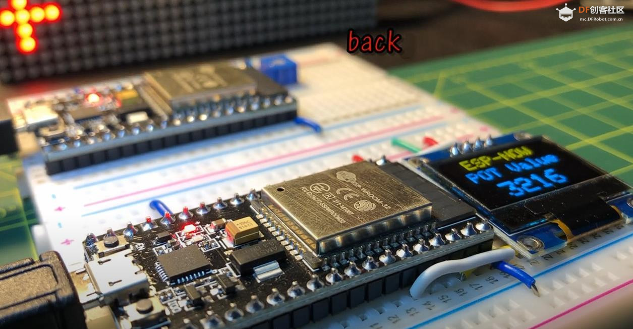

【Arduino 动手做】通过 ESP-NOW 实现 ESP32 到 ESP32 单工通信图1

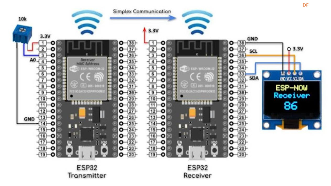

【Arduino 动手做】通过 ESP-NOW 实现 ESP32 到 ESP32 单工通信图2

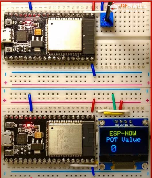

【Arduino 动手做】通过 ESP-NOW 实现 ESP32 到 ESP32 单工通信图3

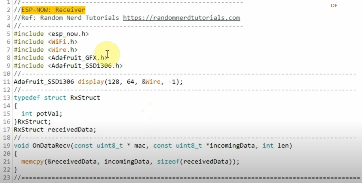

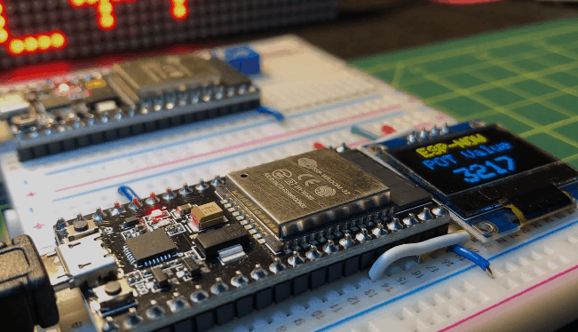

【Arduino 动手做】通过 ESP-NOW 实现 ESP32 到 ESP32 单工通信图4
发表于 2025-6-23 18:05:17
发射机代码
  1. //ESP-NOW: Transmitter
  2. //Ref: Random Nerd Tutorials https://randomnerdtutorials.com
  3. //-----------------------------------------------------------
  4. #include <esp_now.h>
  5. #include <WiFi.h>
  6. //-------------------------------------------------------------------------------------
  7. uint8_t RxMACaddress[] = {0x7C, 0x9E, 0xBD, 0xF5, 0xBE, 0x30};
  8. //-------------------------------------------------------------------------------------
  9. typedef struct TxStruct
  10. {
  11.   int potVal;
  12. }TxStruct;
  13. TxStruct sentData;
  14. //-------------------------------------------------------------------------------------
  15. void OnDataSent(const uint8_t *mac_addr, esp_now_send_status_t status) //callback function
  16. {
  17.   Serial.print("\r\nLast Packet Send Status:\t");
  18.   Serial.println(status == ESP_NOW_SEND_SUCCESS ? "Delivery Success" : "Delivery Fail");
  19. }
  20. //======================================================================================
  21. void setup()
  22. {
  23.   Serial.begin(9600);
  24.   WiFi.mode(WIFI_STA);
  25.   //------------------------------------------------------------------------------------
  26.   if(esp_now_init() != ESP_OK)
  27.   {
  28.     Serial.println("Error initializing ESP-NOW");
  29.     return;
  30.   }
  31.   //-------------------------------------------------------------------------------------
  32.   esp_now_register_send_cb(OnDataSent);
  33.   //-------------------------------------------------------------------------------------
  34.   esp_now_peer_info_t peerInfo;
  35.   memcpy(peerInfo.peer_addr, RxMACaddress, 6);
  36.   peerInfo.channel = 0;
  37.   peerInfo.encrypt = false;
  38.   //-------------------------------------------------------------------------------------
  39.   if(esp_now_add_peer(&peerInfo) != ESP_OK)
  40.   {
  41.     Serial.println("Failed to add peer");
  42.     return;
  43.   }
  44. }
  45. //======================================================================================
  46. void loop()
  47. {
  48.   sentData.potVal = analogRead(A0);
  49.   //-------------------------------------------------------------------------------------
  50.   esp_err_t result = esp_now_send(RxMACaddress, (uint8_t *) &sentData, sizeof(sentData));
  51.   //-------------------------------------------------------------------------------------
  52.   if (result == ESP_OK) Serial.println("Sent with success");
  53.   else Serial.println("Error sending the data");
  54.   //-------------------------------------------------------------------------------------
  55.   delay(500);
  56. }
发表于 2025-6-23 18:06:38
接收机代码
  2. //ESP-NOW: Receiver
  3. //Ref: Random Nerd Tutorials https://randomnerdtutorials.com
  5. #include <esp_now.h>
  6. #include <WiFi.h>
  7. #include <Wire.h>
  8. #include <Adafruit_GFX.h>
  9. #include <Adafruit_SSD1306.h>
  10. //-------------------------------------------------------------------------------------
  11. Adafruit_SSD1306 display(128, 64, &Wire, -1);
  12. //-------------------------------------------------------------------------------------
  13. typedef struct RxStruct
  14. {
  15.   int potVal;
  16. }RxStruct;
  17. RxStruct receivedData;
  18. //-------------------------------------------------------------------------------------
  19. void OnDataRecv(const uint8_t * mac, const uint8_t *incomingData, int len)
  20. {
  21.   memcpy(&receivedData, incomingData, sizeof(receivedData));
  22. }
  23. //======================================================================================
  24. void setup()
  25. {
  26.   Serial.begin(9600);
  27.   if (!display.begin(SSD1306_SWITCHCAPVCC, 0x3C))
  28.   {
  29.     Serial.println(F("SSD1306 allocation failed"));
  30.     for (;;); // Don't proceed, loop forever
  31.   }
  32.   display.clearDisplay();
  34.   WiFi.mode(WIFI_STA);
  35.   if (esp_now_init() != ESP_OK)
  36.   {
  37.     Serial.println("Error initializing ESP-NOW");
  38.     return;
  39.   }
  40.   esp_now_register_recv_cb(OnDataRecv);
  41. }
  42. //======================================================================================
  43. void loop()
  44. {
  45.   display.setTextColor(WHITE); display.clearDisplay();
  46.   display.setTextSize(2); display.setCursor(20,0); display.print("ESP-NOW");
  47.   display.setCursor(10,18); display.print("POT Value");
  48.   display.setTextSize(3); display.setCursor(25,42); display.print(receivedData.potVal);
  49.   display.display();
  50. }
